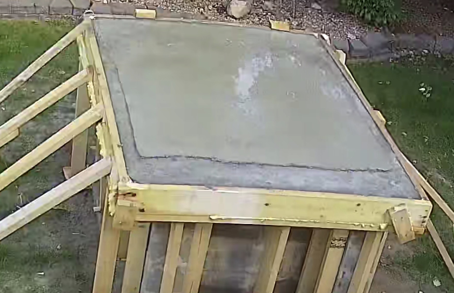

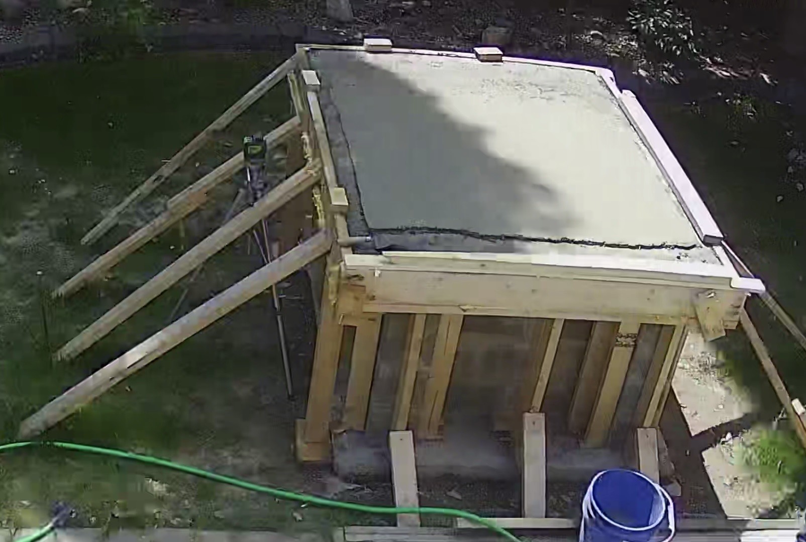

      I used today1.5 bags of "Quikrete Sand/Topping Mix 25KG Model # 110326" to level the top slab, only where oven foot print will be,~52"x~52" . I used my laser level to check everything. one back side of the layer was almost zero and front level was the thickest at about 1.5".
      I will mostly proceed with the casi 40mm+CFB 2" insulation only. now waiting for everything to cure and keep thinking every day if I should cast a castable refractory doughnut under dome walls or lay it directly on top of CaSi board. if I was to not use doughnut support, it will be dome bricks==> CaSi==> Ceramic Fibre Board==> concrete slab with hearth will be same, as well as archway. if I was to cast a castable refractory doughnut then only the dome will be different that the dome bricks first course will set on a 2.75" thick doughnut 32" inner diameter 42" outer diameter(1" thick extra for edging protection and expansion of dome) and will skip first dome spring/soldier course to compensate for extra height. Click image for larger version  Name:	IMG_E8846.jpg Views:	0 Size:	256.9 KB ID:	471752
      after 4 hours, got a misting and covered with vapour barrier and tarp

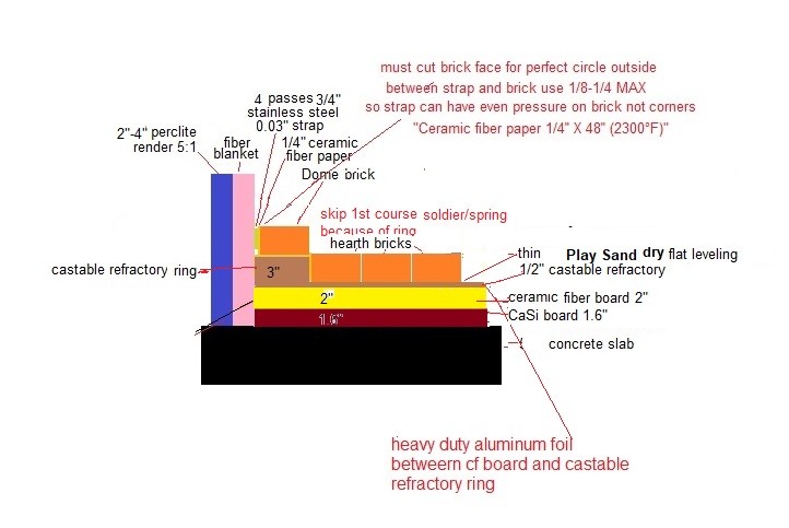

        my plan for the insulation and support stack as my oven design will have dome, hearth, and archway NOT connected , rather have ceramic fibre rope/paper between them to locks air and heat. that is a stand alone shell oven. while aluminum foil could trap moisture, it will also seal the fiber dust from the board as it allows the thin castable refractory moisture to not be absorbed by the board
        • #64
          Aluminium is highly conductive. It only works to reflect radiant heat when surrounded by air. Just as it is useless if installed as insulation if touching another conductive material like a steel roof. Apart from this issue when used anywhere in an oven it can also create a vapour barrier. This can be partly offset it the foil is perforated. Another example of this is the perforated pizza trays sometimes used in an effort to stop pizza bases being soggy. Best to cook them directly on the firebrick floor.

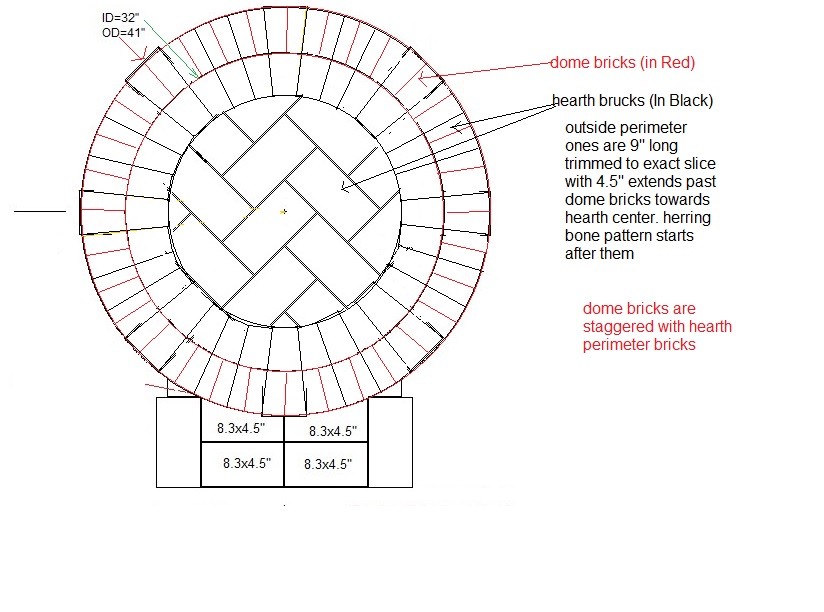

            Click image for larger version  Name:	hearth supports dome.jpg Views:	0 Size:	100.9 KB ID:	471798 ​
            wondering if using hearth bricks as support for the dome bricks is sufficient such that hearth brick under a dome brick would be kept at 9" length shaped as a perfect slice with dome brick staggered placed over two of those hearth perimeter slice bricks. any settlement of insulation layer or hearth will propagate minimally to the dome bricks as its 9" long (vs 4.5" for dome) toward centre, and each dome brick is supported by two of those. This will require stainless steel banding around the hearth too (not just dome) so hearth bricks wont rotate sideways. wondering if this has been tried and if its as robust and stable as a solid castable refractory doughnut ring outside the hearth? I am sure its double the stability of placing the dome on CaSi board directly or even a herring bone hearth without banding
            • #66
              Brick kilns sometimes have steel bracing for containment and which is adjustable to accommodate expansion and contraction. However with service temperatures often well in excess of double the temperatures we use for our ovens leads to over double the thermal expansion. For a WFO expect the thermal expansion to only reach around 1%, so it is debatable is a steel band, particularly if it is not adjustable, is of much use. Attention needs to be given to the much higher temperature of the floor-bricks in the centre which will be expanding well before heat has time to reach the steel band to allow for its expansion. The steel band at the base of the dome is usually only ever seen on ovens that depart from the hemisphere, namely those that use soldiers for the first course which creates a stability issue. The advantage of a soldier course is that it provides greater height at the base of the dome interior.
              • #67
                can 1/8" ceramic fibre paper be put under dome brick only between dome brick and hearth deck under them without mortar (keeping the dome brick on the slip ceramic fibre paper sheet)? would the dome slip and collapse? - assuming I am using stainless steel banding to hold dome outward thrust- or they must be mortared?
                • #68
                  The weight of the dome on that junction is unlikely to allow for any movement there. It is the gaps between the loosely laid floor bricks which don’t have any weight on top of them, which does the job that allows for the expansion. Both the perimeter floor bricks and the bottom dome bricks sitting on top of them will receive the same rate of temperature increase and hence the same rate of thermal expansion, making a slip layer unnecessary in that position in my opinion. Others may disagree

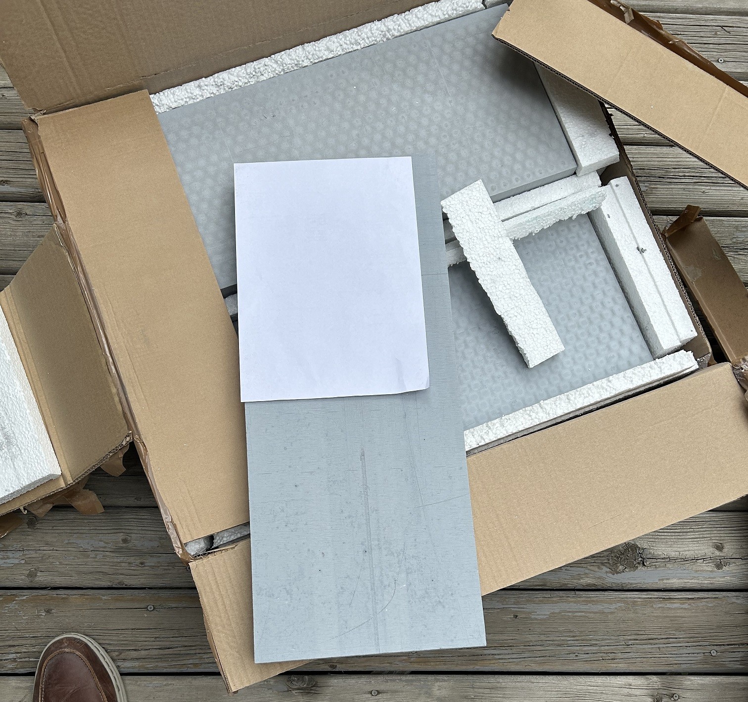

                        Click image for larger version  Name:	IMG_8856.jpg Views:	0 Size:	720.8 KB ID:	471854CaSi boards arrived today, will be removing the workform of the concrete slab on the weekend and let the slab dry out for about a week and then will start the construction of the oven

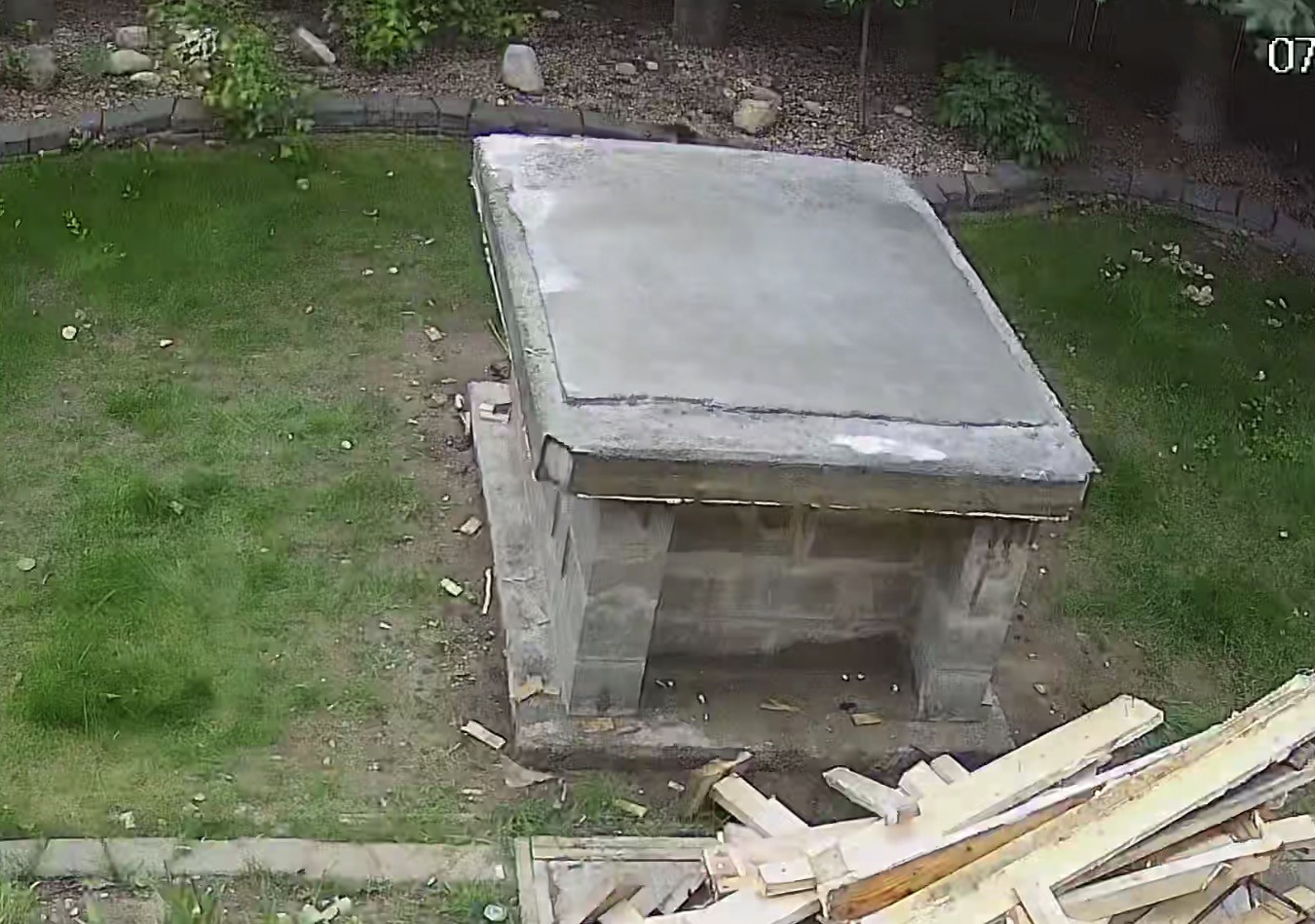

                              removing the workform lumber, slab needs tiny smoothing on edges and corners otherwise appears really solid and dense

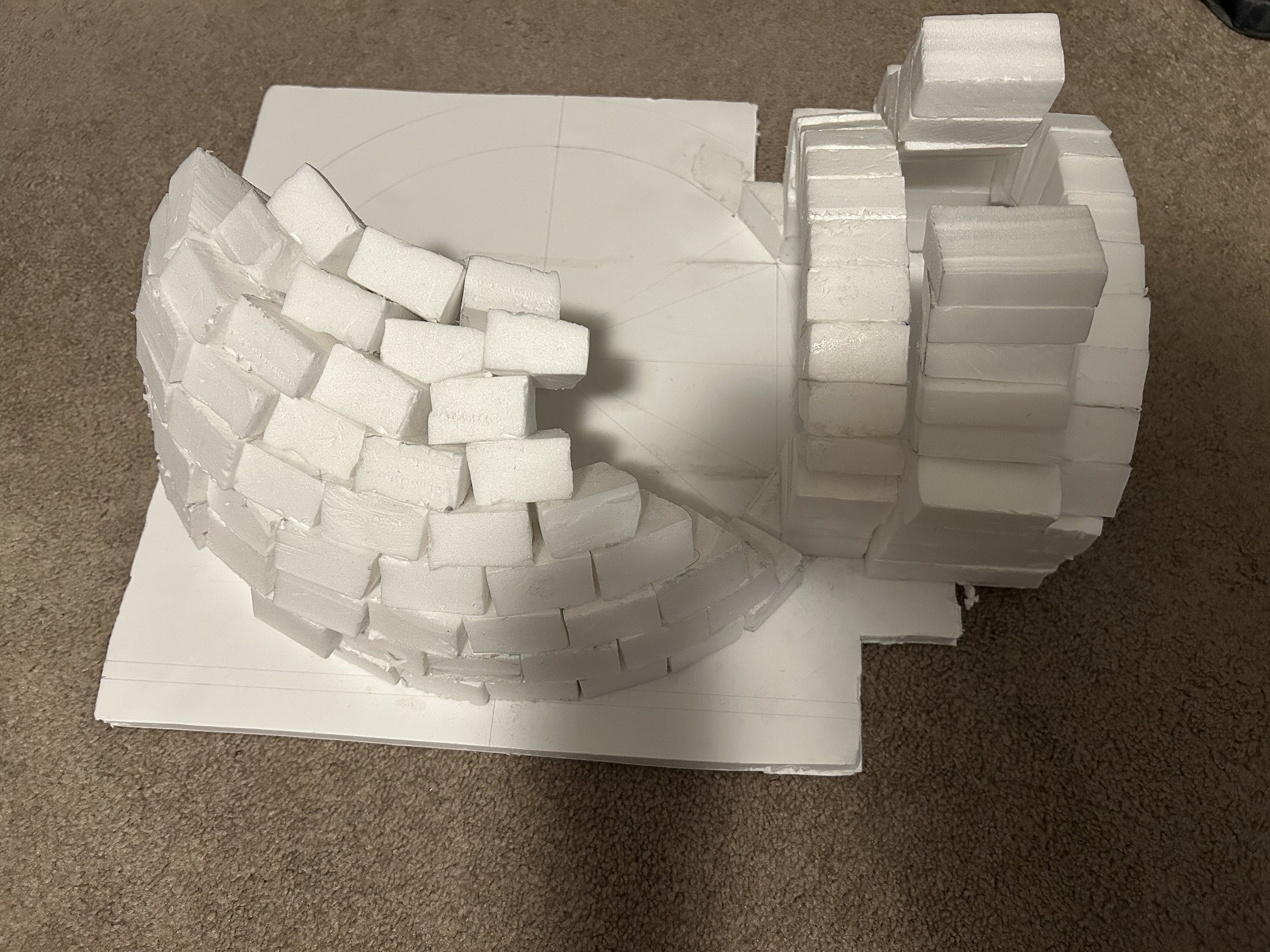

                              • #75

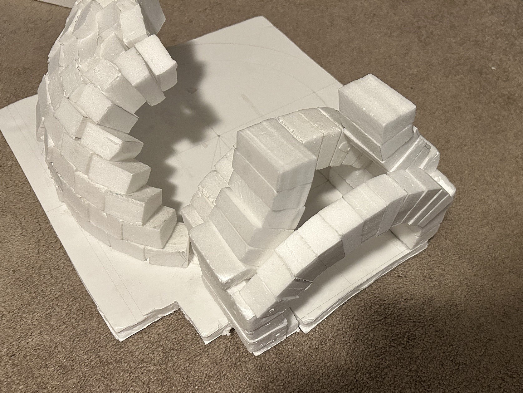

                                My little practice to confirm theoretical brick count for first few courses :very untidy and out of order as the cuts are very not precise at that scale; however it helps someone know how and where to start:
                                Click image for larger version  Name:	IMG_8900.jpg Views:	0 Size:	660.8 KB ID:	471977
                                ​ Click image for larger version  Name:	IMG_8898-s.jpg Views:	0 Size:	898.3 KB ID:	471975
