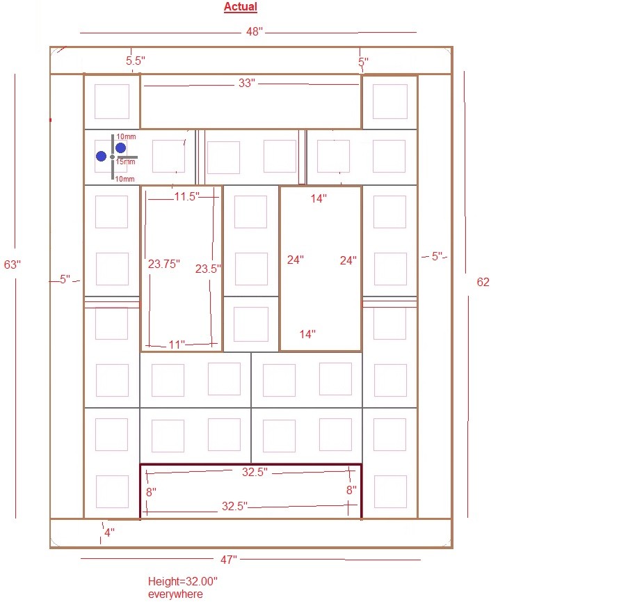

            Thank you, my design diagrams fell short of the actual. I saw many videos and have idea of the shape. I will try to keep the block near the inner arch a full brick. as for the mortar gap, each time I cut the width will be less than an exact half because of the blade thickness. moreover, I plan to cut larger and trim later as cutting shorter is irreversible.

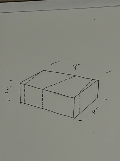

                This method of cutting the bricks (depending on their actual size) may be helpful in reducing the number of cuts (3 cuts gives you two bricks), with minimal wastage. The wedges can also be used to fill gaps from the outside.

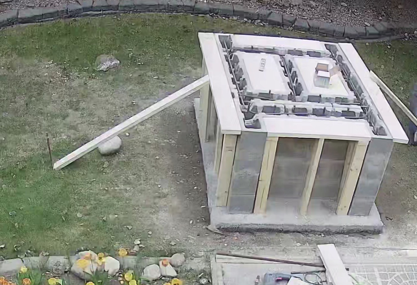

                  Today's progress: completed the centre work-form (the one that will never be removed after pouring the slab), and partially the first perimeter work-form. next is the outer most perimeter work-form.

                    Thanks, I've seen this on the forums and might use it. however, it could cost another wood jig for the wet saw to cut it, I might just cut half all of them and then make jigs for each course (I might need 2-4 jigs per each course however I would once finish fully a course re-use the same jigs and make the angle cut less). my wet saw has nothing to mitre except the 90 degree tray and I will be making the custom mitre jigs . I chose to have the entire dome be derived from same cut (taper and wedge) however as courses go up there is another two cuts on it to fit it in the sphere ( so not really all jigs need to be constantly changed per course)

                      No don’t cut them in half first. You will waste cutting time, blades and create double the amount of offcuts. As each chain rises so the angle becomes greater. If you can’t use a jig just mark out the brick with a template and cut to the marked line without a jig. It’s not hard.

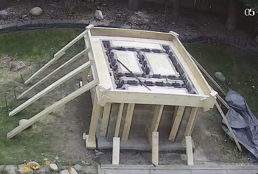

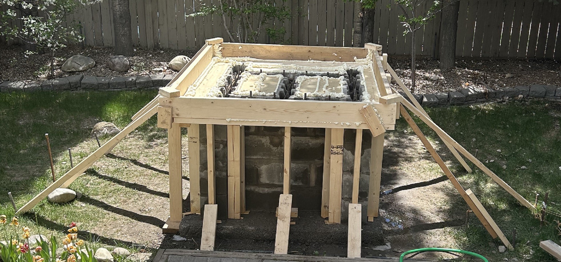

                          today's progress:installed more of the work-form, still need to fill gaps, secure work-form for slab load , and test rigidity.

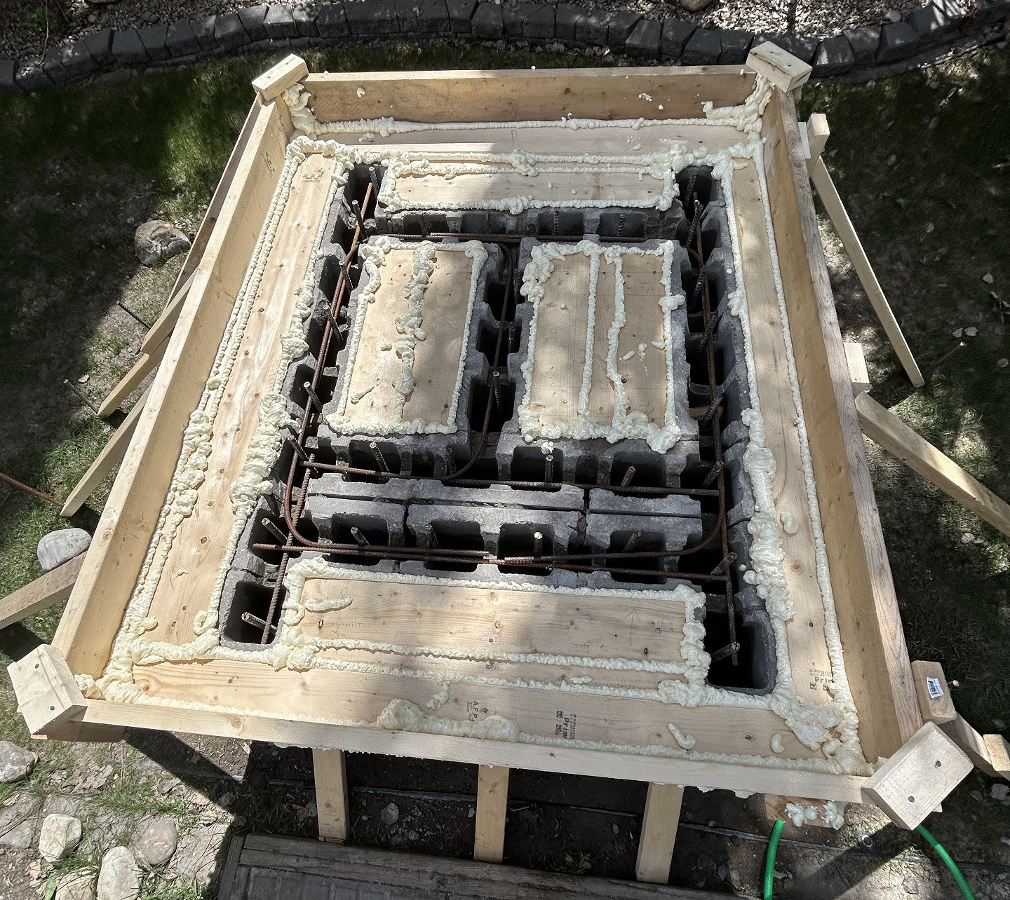

                            I finalized the workform today and sealed the gaps with window and door expanding insulation foam, will trim excess after it cures. next will be waiting for good weather to grout all the cores with about 30 30kg bags adding air entrain admix:

                              Because all concrete is somewhat porous you may want to consider adding a waterproofing additive to the concrete for the supporting slab, I use Xypex. Water wicking up from the base can find its way into the inner parts of the oven where it can become problematic and difficult to remove. This is highly weather dependent of course, but never allow sprinklers against the stand for this reason. Another solution to this problem is to paint a sealer over the top of the supporting slab, but I have no idea about its longevity or how a sealer would stand heat.
                              30 x 30 kg is a lot of hand mixing, have you compared readymix pricing? You should be able to pour the cores and slab top in one go.
