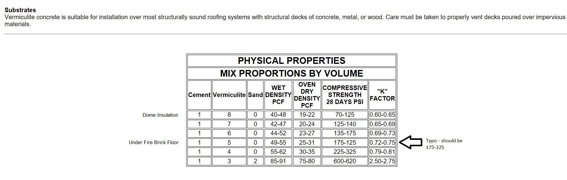

    Our goal is not to harp on the issue but to make you oven the best it can be. With all your hard work of planning and design, it will be a great oven. A 5 to 1 pecrete mix is suggested for under the floor and dome since this ratio has enough compression strength for supporting the dome and floor and adequate insulation value. Roughly 4" 5 to 1 pcrete equals 2" CaSi. So a total of 4" CaSi equivalent is a very good insulated floor.

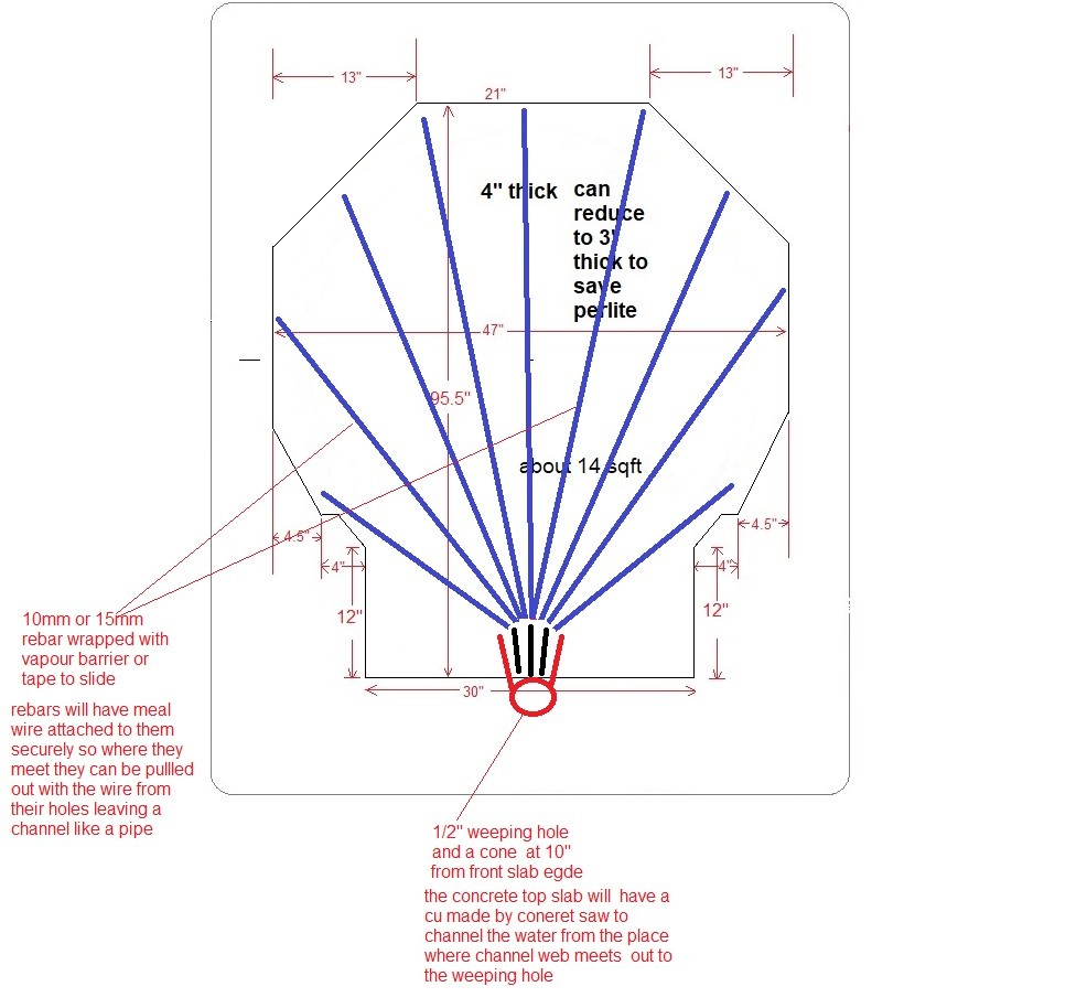

              if I lay rebars on top of concrete slab then pour the perlite-cement on them (as shown in above image), after the layer is cured, the rebars can be pulled out leaving a hollow channel in the insulation layer where water can seep out, the channels will meet near the oven mouth area, then concrete saw shallow cut on concrete slab will channel the water further to the front edge of the concrete slab (there is no insulation there, finally a 1/2" hole is drilled at about 10" away from the front edge of the slab allowing any water to weep and drain there. of course, the water channel can be covered with a masonry layer/sheet later to prevent water from back flowing. It might be that half of those channels are needed (like 5 or 3 instead of 9. what do you think? does that work?
              • #52
                This idea should work quite well. Because rebar contains ridges designed to increase grip and reduce pull out I think some plastic conduit wrapped neatly in plastic would be far easier to pull out, but I’m sure you’d work it out. Also spraying with cooking oil helps release anything from concrete work.

                  That is something new, will be interested on how this works. Remember, even 5 to1 pcrete seems crumbly until it sets up so don't pull out too soon. Dave brings up a good point on the rebar ridges but maybe the vapor barrier will solve the friction issue of pulling the bars out. What about reversing the direction of the weep hole and rebar then the weep hole is in the back of the oven slab, out of sight out of mind.

                      how about that:
                      1)a hole cut straight through the top slab into the open air space beneath CMU block walls will turn into a cold-air intake. When oven is hot, it will draw cold, damp air up through those drainage holes right into the insulation.
                      2) Freeze-Thaw Ground Moisture: In the spring, melting snow and ground moisture under oven base will evaporate upward. Those open holes in the slab will act like funnels, sucking ground humidity directly into perlite and ceramic fiber layers, causing the exact water-logging issue I am are trying to prevent.​
                      3) heat-loss paths,
                      4) moisture migration paths
                      5) insect nesting locations (even using stainless steel mesh, if its not to fine mosquitoes can get in or smaller flies, even crawling insets trying to hide from cold winter. too fine one may clog the channel/hole as debris and dust fills it)
                      6) collection points for debris.​

                        No, air movement by convection requires it to be open at both ends. If really concerned about this point they could be plugged when not required. There’s far more heat loss from the oven mouth because of its much larger area. In high humidity even a roof won’t hold out moisture. We live in the tropics, oven is out in the weather, but I did have an occasion when after drying and using the oven, two weeks later in a period of very high humidity, but no actual rain, on heating the oven again, the outside shell was hot after an hour of firing, which indicates the presence of moisture in the insulation layers.
                        Any weep holes should be covered with insect mesh.

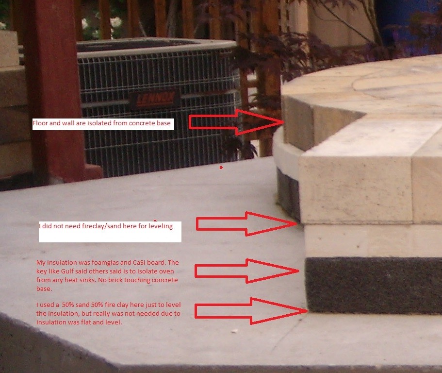

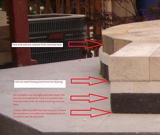

                              If you can find it, FoamGlas is an alternative to P/vCrete or CaSi for the first layer. It will not absorb or transmit water and has similar K value to CaSi. I used it in my build but it is difficult to find.
                              Click image for larger version  Name:	30A Brick Floor on Insulation edited 2.2014.jpg Views:	5 Size:	153.8 KB ID:	471627
