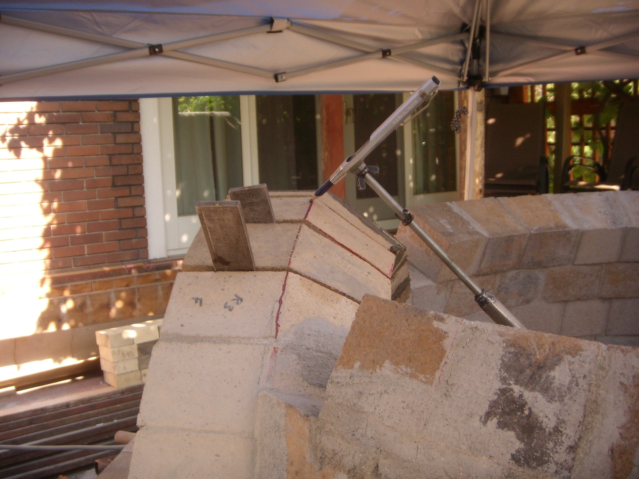

      • #78

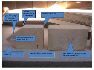

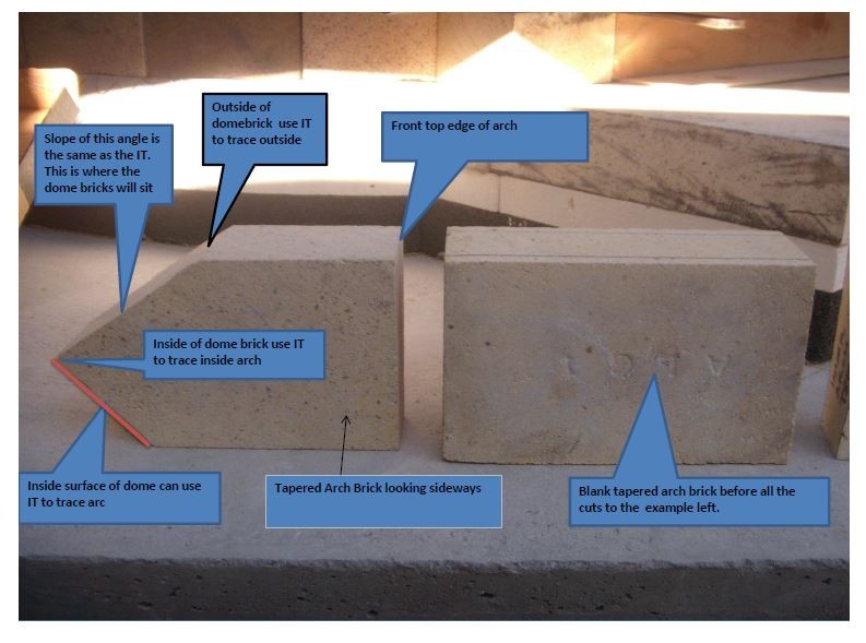

        Can't remember if we talked about a tapered inner arch configuration. Takes a little more work up front but makes the tie-in of the dome to the inner arch more precise and easier. Click image for larger version
ID:	471947 Click image for larger version
Name:	41A Course 5 7.4.12.jpg
        • #79
          Yes, thanks for the extra photo, we talked about it on here earlier. Having it on the right angle helps making the dome and arch curves intersect as an arch into compression perpendicularly for their joint surface.

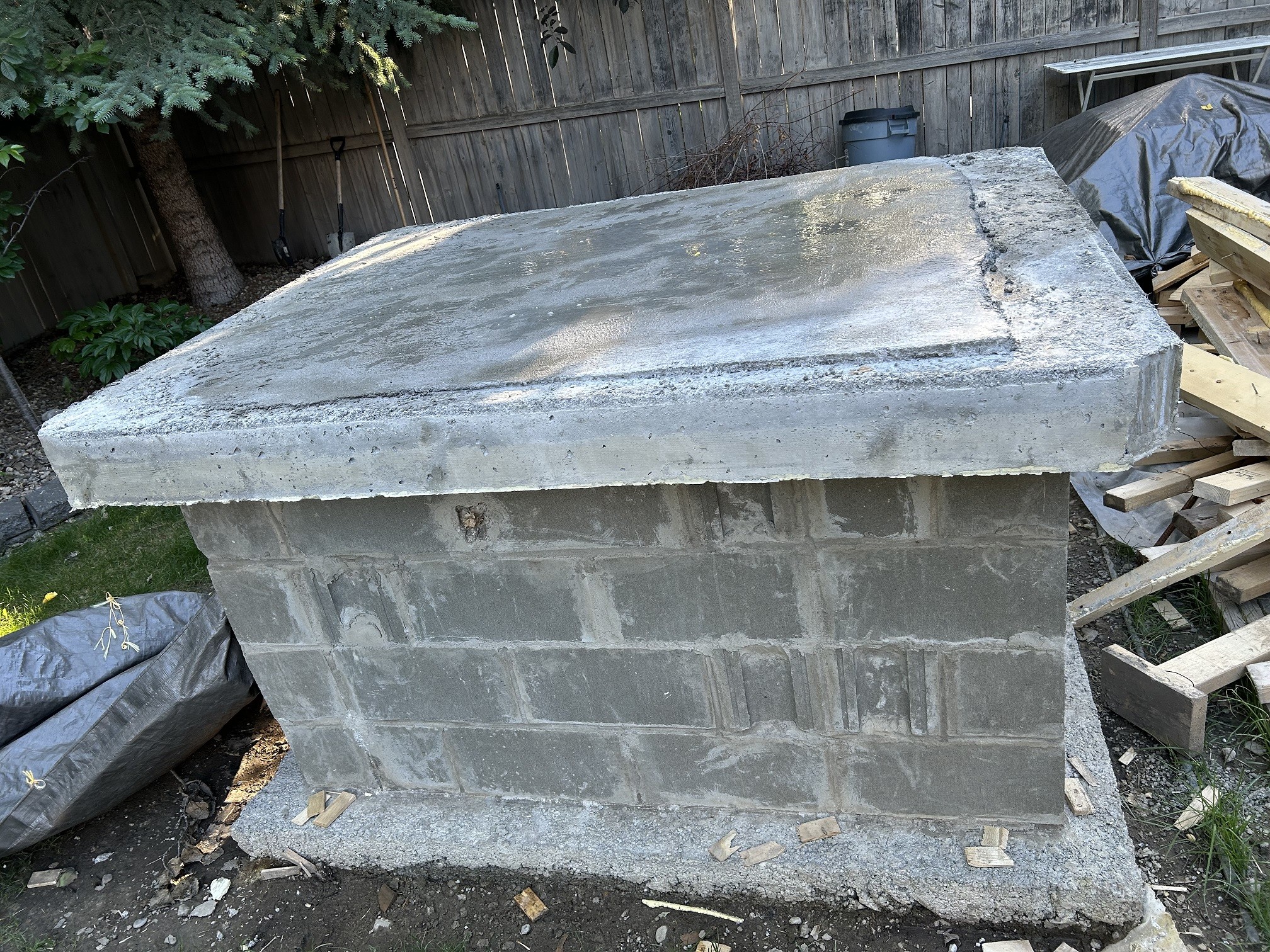

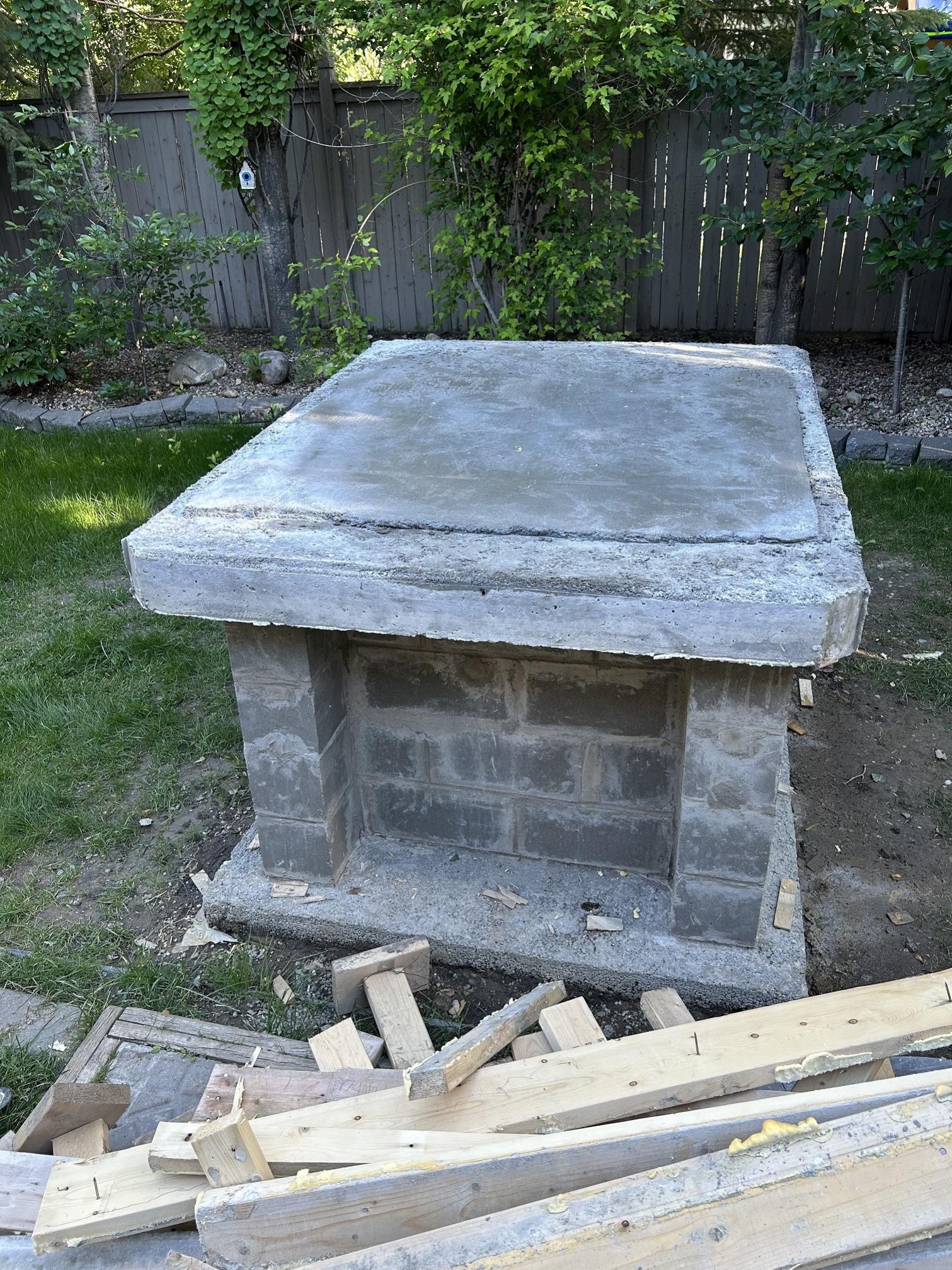

          • #80
ID:	471971 Click image for larger version

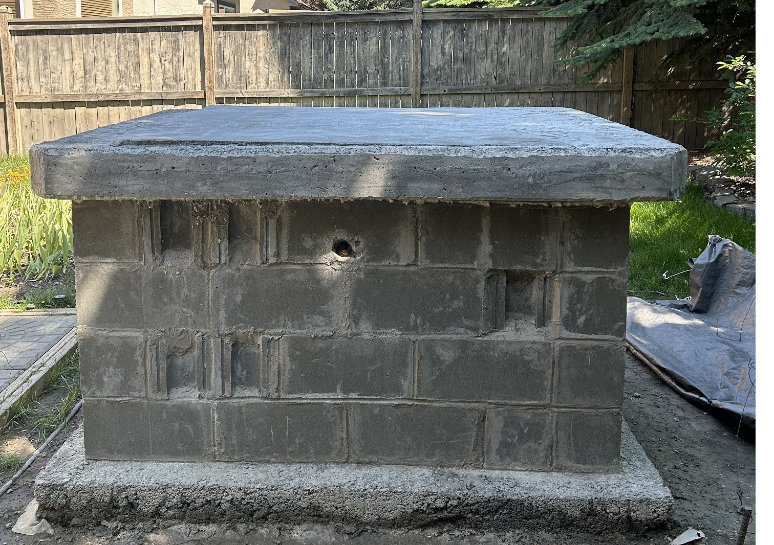

            Here is how my foundation looks like after removing all the lumber work-forms. I will use grinder to grind the edge and corner surface as its a bit rough, might smooth the levelling layer gently as well because when I protected it with vapour barrier after pouring (trees where shedding spring things did not want the surface get sprinkled with them for 4-6 hours until its sets) it spoiled the smoothness of the surface very tiny (not mechanically relevant but smoothing it would be very easy to smooth , can be even done with an edger without any grinder here to keep it gentle or with a sand paper)

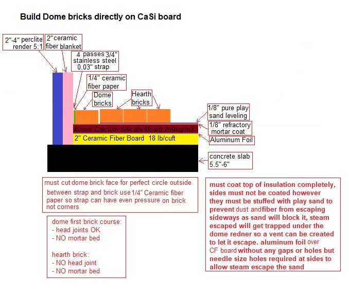

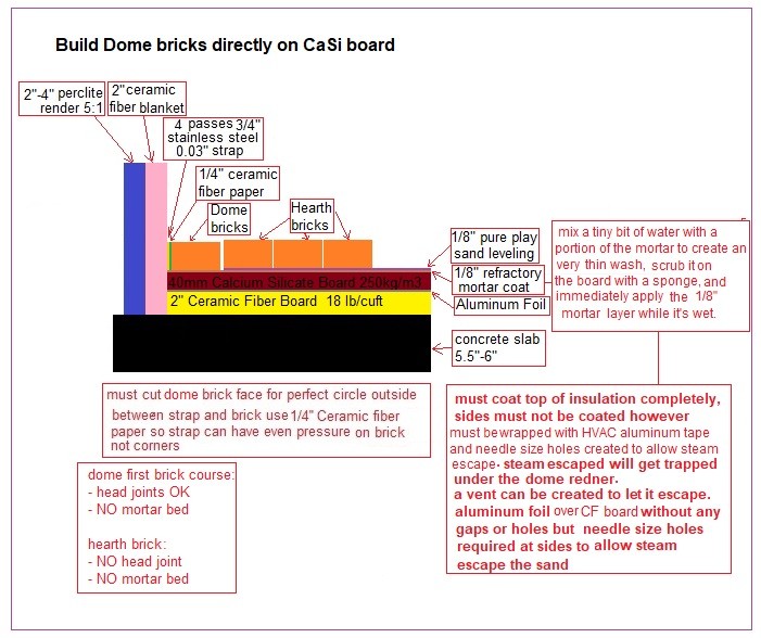

              I think I have made my mind on final insulation stack. I hope it will work. what do you think?
              ​ Click image for larger version
              • #82
                I’ve already posted what I think about the stainless bands around the base of a brick dome hemisphere, the use of aluminium foil and the need for weep holes and lifting the underfloor insulation to provide moisture pathways to them, so I won’t repeat my cautions. Two additional things to consider are
                1. applying a thin refractory mortar layer over dry highly hygroscopic insulation is nigh on impossible as it dries almost instantly making an even layer impossible.
                2. A thick 2-4” vermicrete contains a very large amount of water ( do the volumetric calculation at. 40% water) most of which remains as free water which is problematic until removed. 5:1 is not particularly a great insulator (1/2 as good as blanket) and also not particularly strong. What are you trying to achieve with this layer? Will anything else be applied outside it?
                • #83
                  the purpose of the 1/8" refractory mortar is to seal the fibres and dust form the boards not structural or levelling, as long as it dries and not flakes out then it would have done it purpose (consider it rigidizer and seam glue). I am not using any percrete for the floor insulation, those vertical ones or for the dome render.

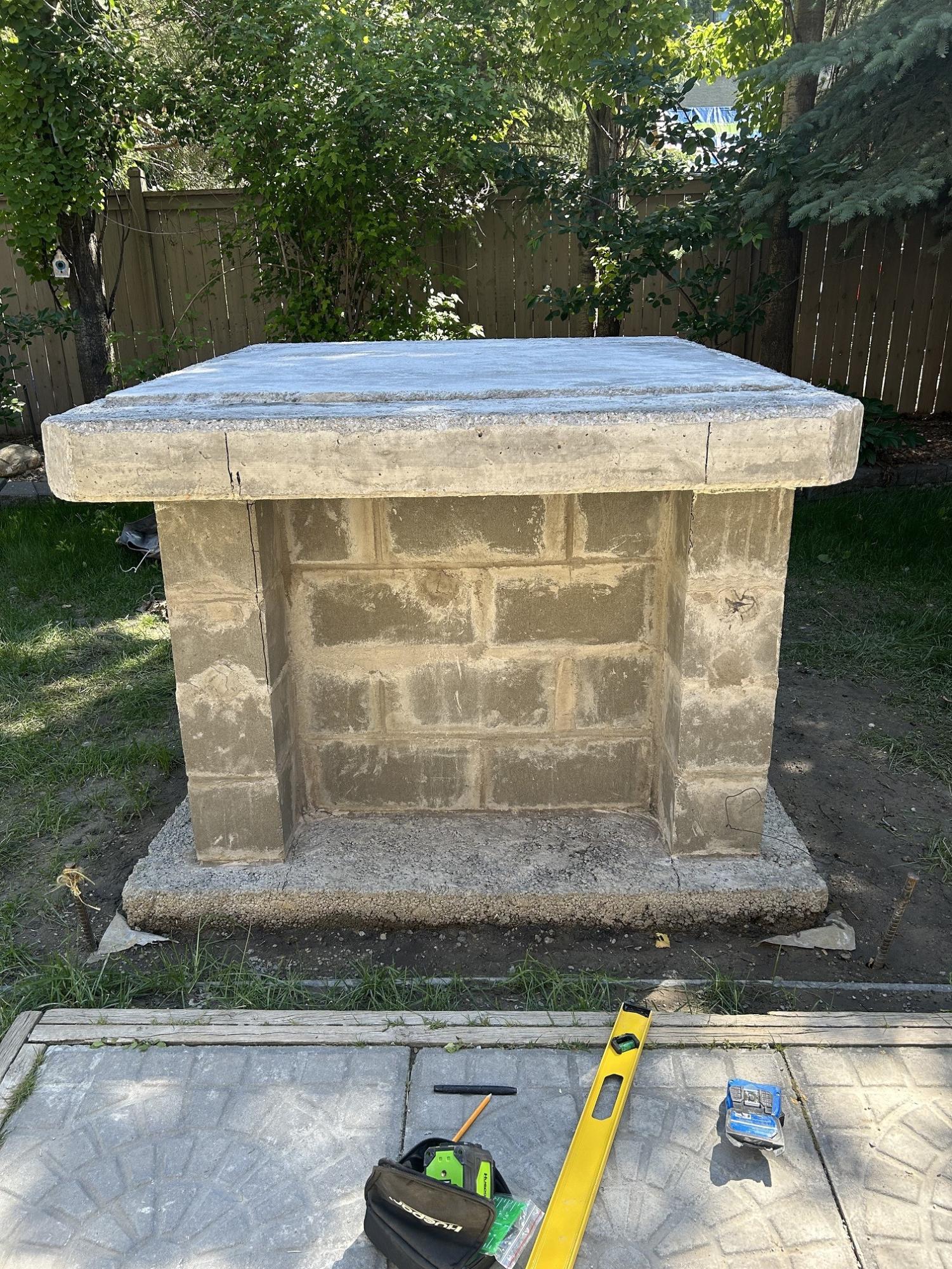

                  • #84

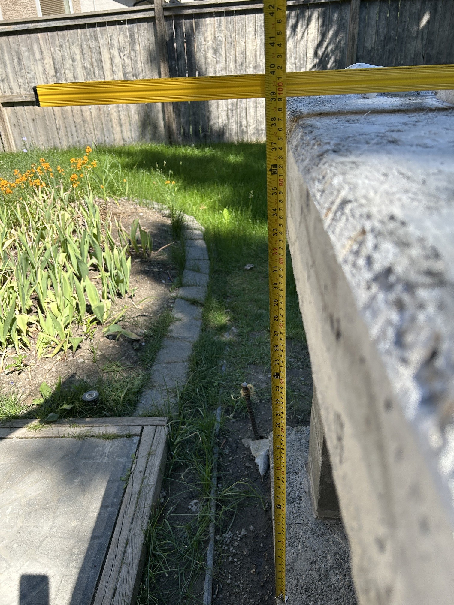

                    it looks like my concrete slab top surface on top levelling layer is 39" above the bottom slab surface (and almost same from the pavement in front of it, may be ~40":
                    Click image for larger version  Name:	IMG_8917-s.jpg Views:	0 Size:	742.7 KB ID:	472022
                    Click image for larger version  Name:	IMG_8914-s.jpg Views:	0 Size:	709.3 KB ID:	472020 Click image for larger version  Name:	IMG_8923-s.jpg Views:	0 Size:	1,008.8 KB ID:	472019
                    Click image for larger version  Name:	IMG_8925-s.jpg Views:	0 Size:	1.24 MB ID:	472021

                    • #85
                      Yes, your attached plan clearly shows it to be outside the dome insulation. Is tha perlcrete layer for additional insulation or for strength? What is the purpose of a thick 5:1 layer over the blanket insulation? Do you plan on covering it with anything?
                      your planned oven floor working height should work out to be ideal.

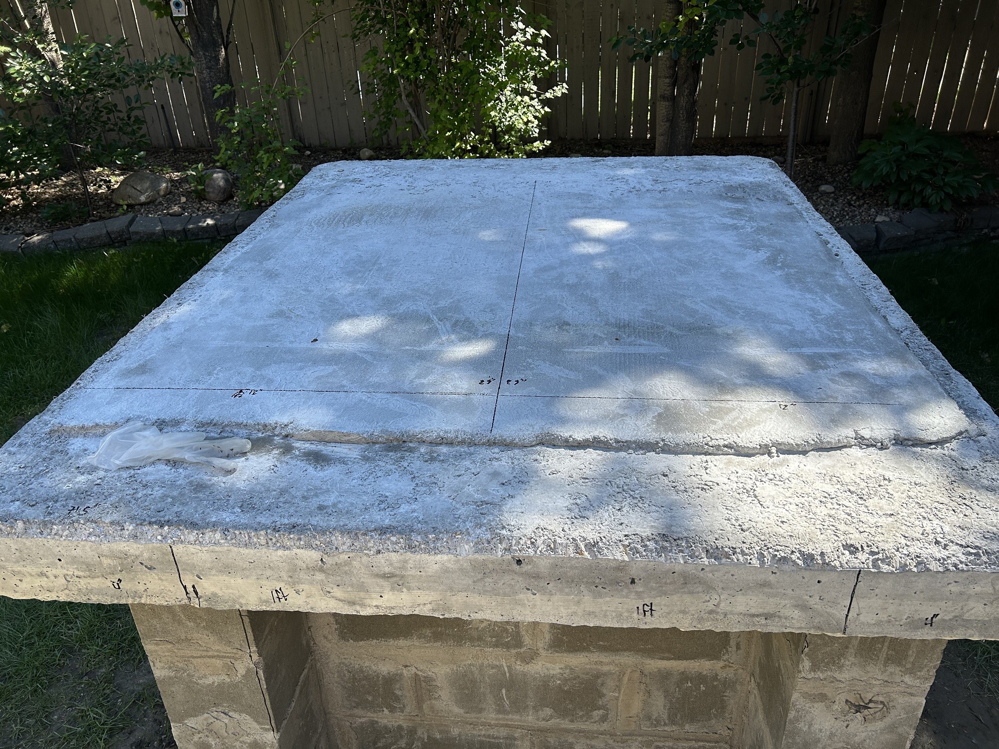

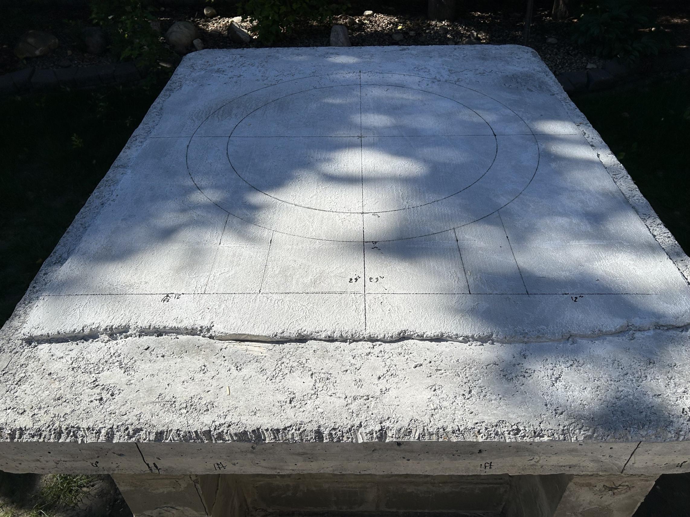

                          as the wet cure and staged drying phase is over, I today got the slab uncovered to get it baked and dried in the sun. did initial marking for the oven foot print:

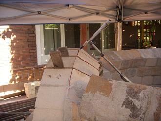

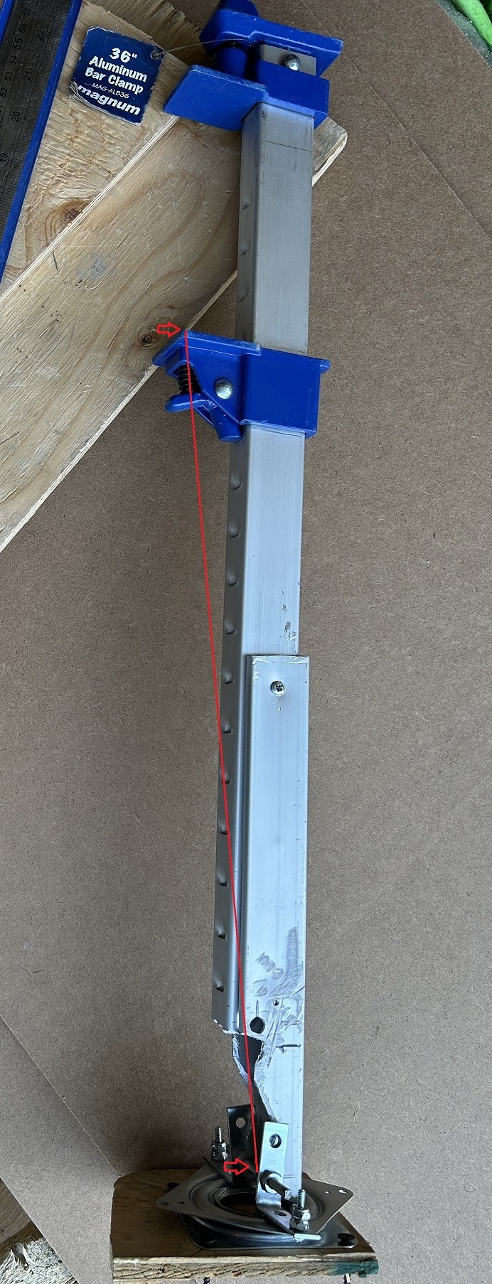

                          • #88

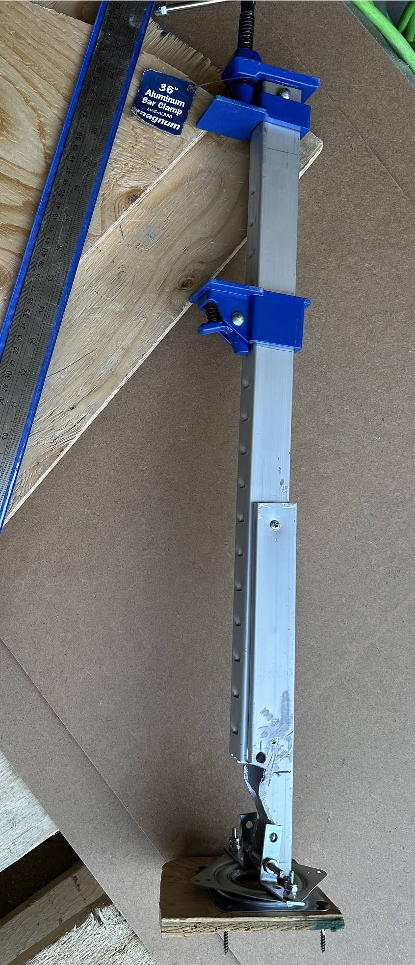

                            I today made the indispensable tool , unlike most of DIY design you see using caster wheel, I used lazy Suzan bearing instead. I found that the caster wheel has its vertical axis and horizontal axis do not intersect leading to a torus/doughnut outcome not sphere. I did use a back arm to fix the caster wheel axis issue but the problem it was too high for my low dome sphere and found that lazy Suzan bearing will provide the best of everything: very thin, no need for back arm and then trammel arm (double the inaccuracy and joints lots of play), the axis can be made to intersect leading to a perfect sphere output. I also created a quarter circle from 1/2" plywood(not shown in pictures) made with my dome's radius to double check the curve. my dome radius is supposed to be 16 1/8" . I repeatedly measured the actual radius (while trammel is at 0 degrees) and it is 16 1/8' exact. Here are the pictures :
                            Click image for larger version  Name:	IMG_8967-s.jpg Views:	0 Size:	688.0 KB ID:	472142
                            Click image for larger version  Name:	IMG_8970-s.jpg Views:	0 Size:	329.7 KB ID:	472141
                            • #89

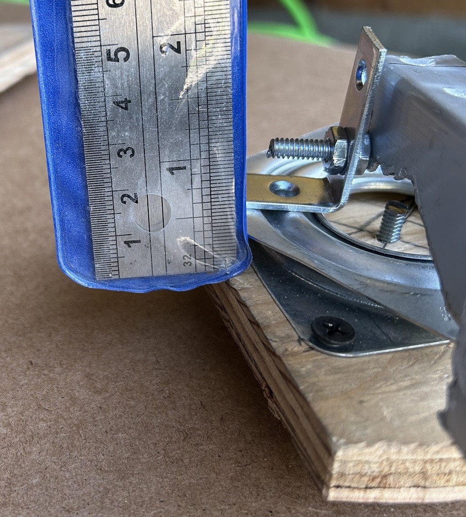

                              FYI, The vertical ID will be larger than the horizontal ID by the thickness of the plywood and the lazy susan bracket thickness unless you make incremental adjustments as you move up in courses. Also the centerline of the pivot point at the floor elevation to the bracket holding the brick needs to be at center of the brick face or you get a stepping of the bricks that are cumulative as you go up.
                              • #90

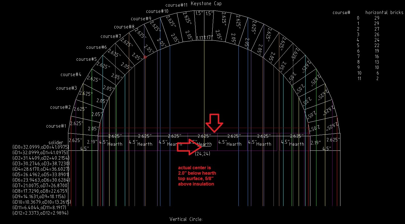

                                Thanks for the observation, I eyeballed and used a ruler to ensure the vertical and horizontal axis (the bolt vs centre of lady Suzan bearing) are intersecting in the centre and the line on arm I used as reference to be the radius of the actual centre is shown in the below picture:
                                Click image for larger version  Name:	IMG_8967-2-s.jpg Views:	0 Size:	502.2 KB ID:	472164
                                Click image for larger version  Name:	Untitled.jpg Views:	0 Size:	213.1 KB ID:	472165
                                I plan to put the base of this trammel above insulation, not on hearth, so the actual centre matches the desired position of the dome centre. There are of course errors everywhere however I try to minimize all I can. its not going to be perfect circle mathematically but very close, and I will use the wood quarter circle as the main reference. I will have to dig in the insulation 1/4" for my trammel to work (or leave a chunk of insulation out and pad it with wood sheets to level ( after finishing I put the insulation and hearth brick cut back).
                                does lowering the trammel to below the hearth fixes the issue you mentioned about stepped vertical circle?
