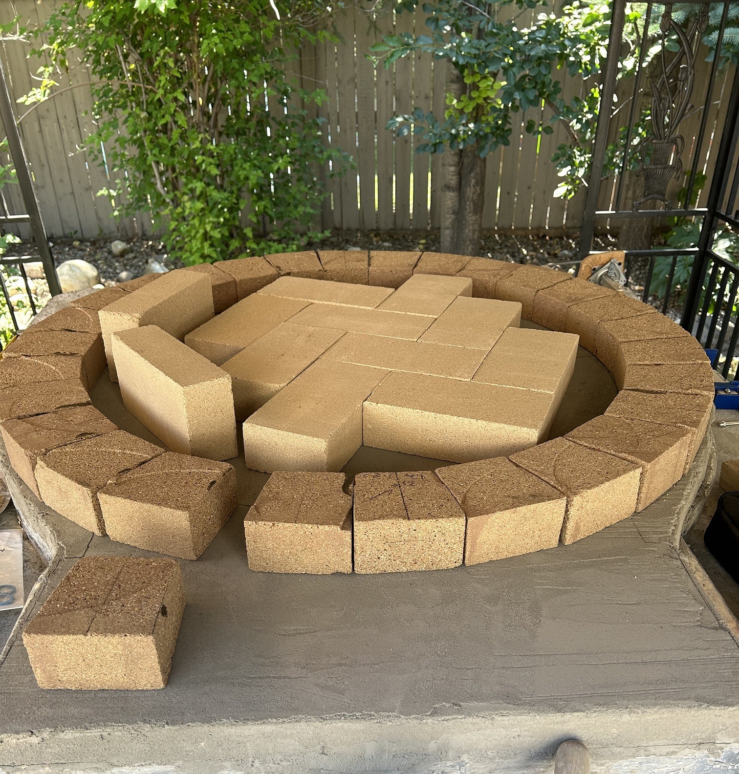

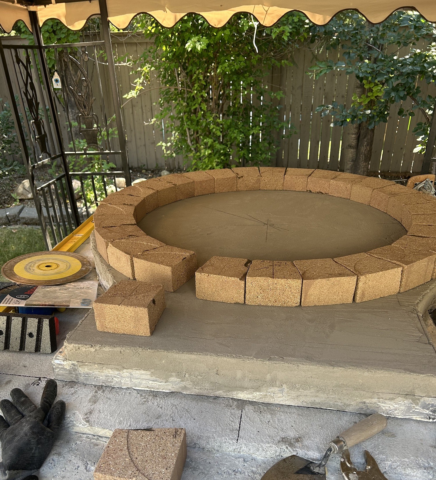

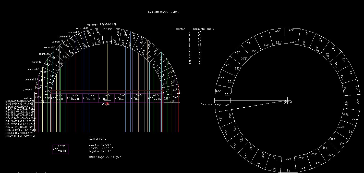

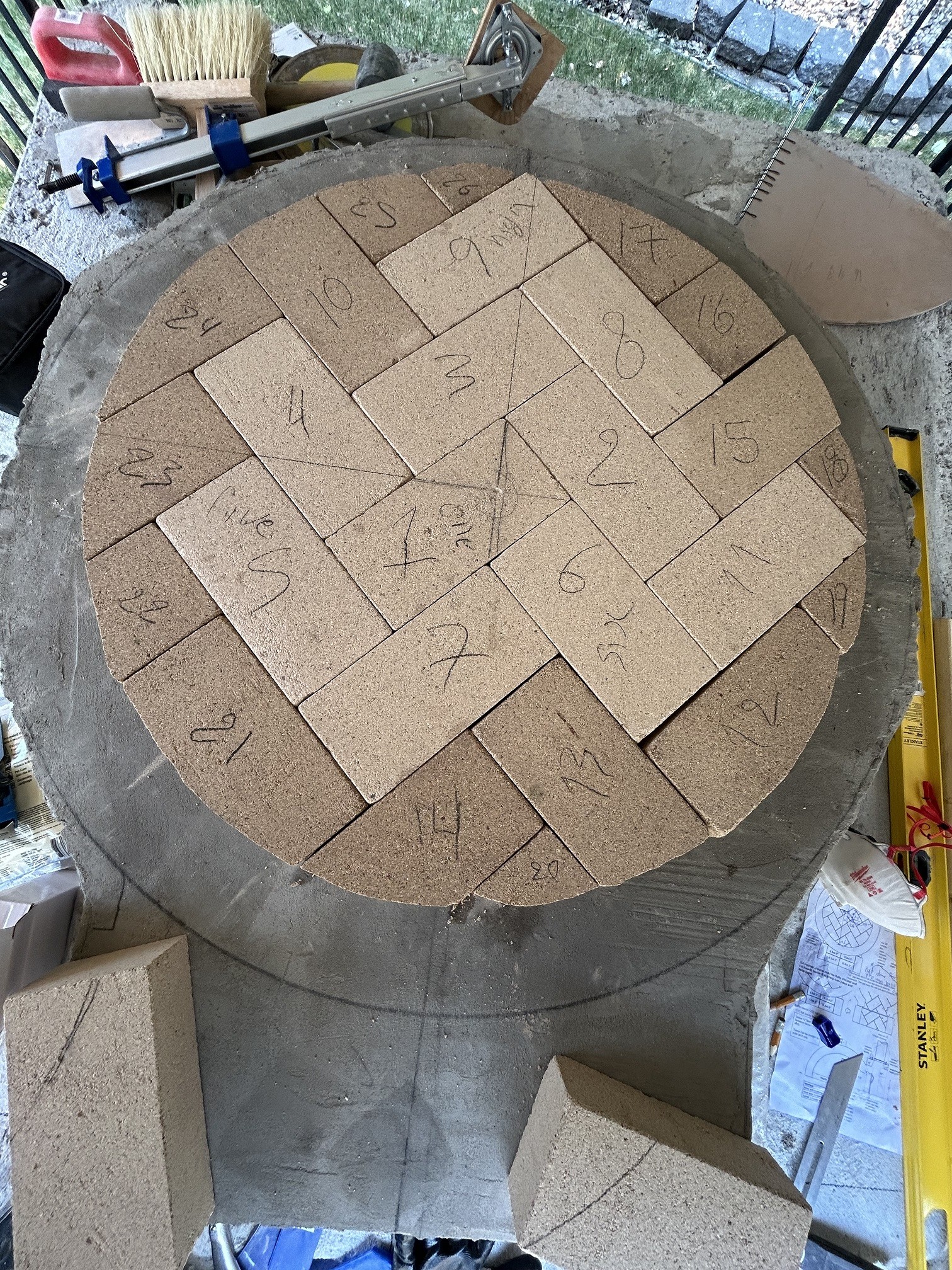

  • my bricks are 9"x4.5"x2.625" each weighs about 3.3kg, so that's about 1850kg/m3. I cut today the spring line course ,two wedges and top taper. course#0 in diagram, I dry fit but will have to cut the hearth bricks (later soon) before I could actually dry fit everything in final position and then assemble with mortar: I noticed my cuts are pretty tight which means the inner surface edges will touch each others however the gap will be more as it goes outside, up to about 1/4" between each bricks and another at the outside. I have huge quantity of grog leftover from wet saw water and shims that I can use to reduce refractory mortar (if needed), I have 100+lbs of Thermobond 915 theoretically enough for 180 bricks at 1/8". here are the pictures:

    • one more showing inside out:

      • If that is your first course of dome bricks then you will not end up with a hemisphere. It probably won’t matter but a true hemisphere should have its base at the same level with the top of the floor. This results in the radius equal to the interior height.
        • Originally posted by david s View Post
          not true for my sphere cap, true for hemisphere, see my diagram. my dome is a sphere cap not a 1/2 (hemisphere)- Neapolitan not Tuscan. its like I cut the bottom of the hemisphere to make it lower. therefore the radial faces can't be flat. the solider will fix the issue as its cut at the corresponding radial angle where the sphere cap sets on it like an arch set on a leg
          • Originally posted by IH123 View Post
            not true for my sphere cap, true for hemisphere, see my diagram. my dome is a sphere cap not a 1/2 (hemisphere)- Neapolitan not Tuscan. its like I cut the bottom of the hemisphere to make it lower. therefore the radial faces can't be flat. the solider will fix the issue as its cut at the corresponding radial angle where the sphere cap sets on it like an arch set on a leg leg
            Ok, then ignore what I posted. I was looking at your plans as posted on #10 which shows a diameter of 32” and a radius of 16” and no soldier course (bricks standing on end)
            Maybe I’m looking at the wrong plans.
              I apologize for the confusion, the oven hearth is 32" diameter /16" radius however because I needed lower dome, the dome radius would be 16 1/8 to yield 14 1/8" height instead of 16". therefore the oven have two circles: hearth D=32", dome D=32 1/4". Except hearth, all my brick cuts are based on the dome radius of 16 1/8".
              I hope that clarifies.
              • Ok, sorry, I didn’t see the drawing posted on post 121. Your first course of bricks (that you call soldiers) are not laid as soldiers, but laid flat conventionally and your hemisphere base is under the floor level. Sorry for my misinterpretation.
                At the density you quoted for your bricks, you shouldn’t have too much trouble cutting them.

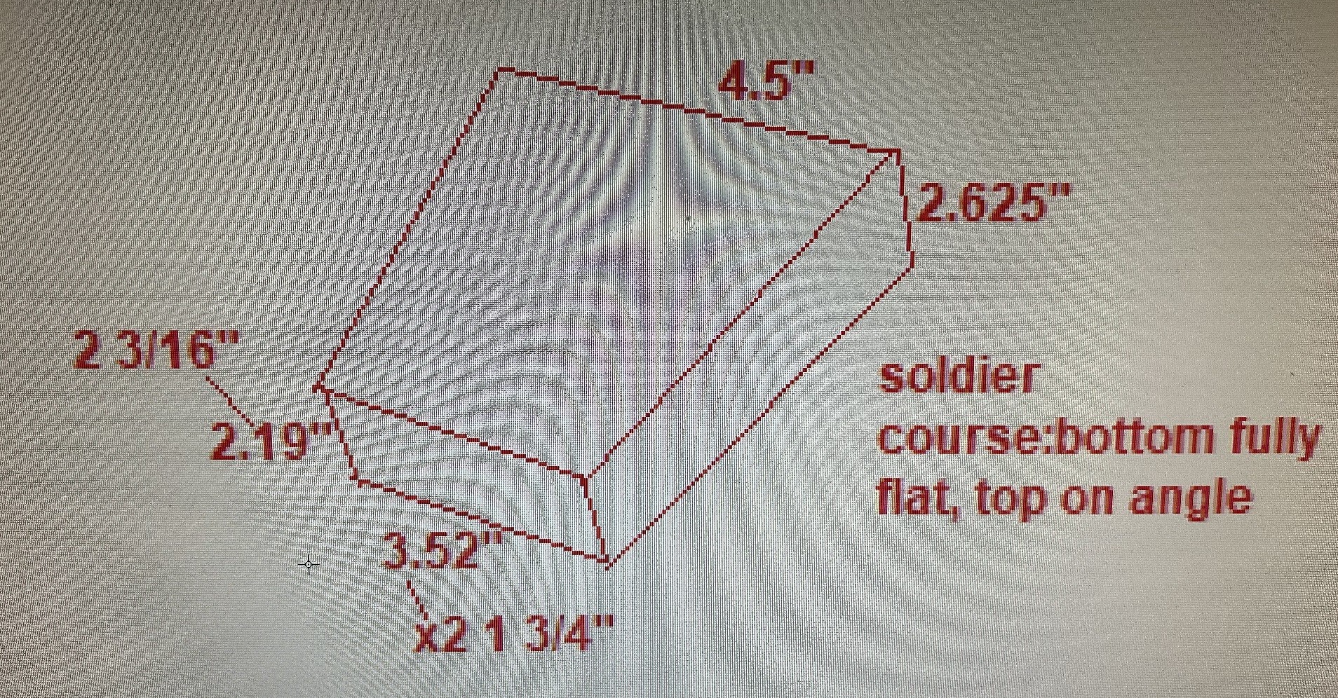

                • I today, marked the dome bricks outer circle to cut them rounded so that banding wont be exerting on edges rather balanced on entire brick outer surface/edge, likely will end up 3 straight cuts instead of circle cut (polygon part instead of circle part cut as its hard to get perfect circle on wet saw for 29 bricks). I also marked the hearth bricks for cuts, which will be about 1/8"-1/4" less than the dome diameter (I guess 1/4" is too much so will try to stick to 1/8"). I noticed the bricks are never same thickness so I will either use the play sand to level them or I could slowly grind and shave them as needed with rubbing brick to make them levelled. I feel shaving them with rubbing stone (grinding action) might be more stable for long term than having floating play sand. if I cant shave the bottom easily or if it takes too much then I will of course use the play sand, here is the picture:

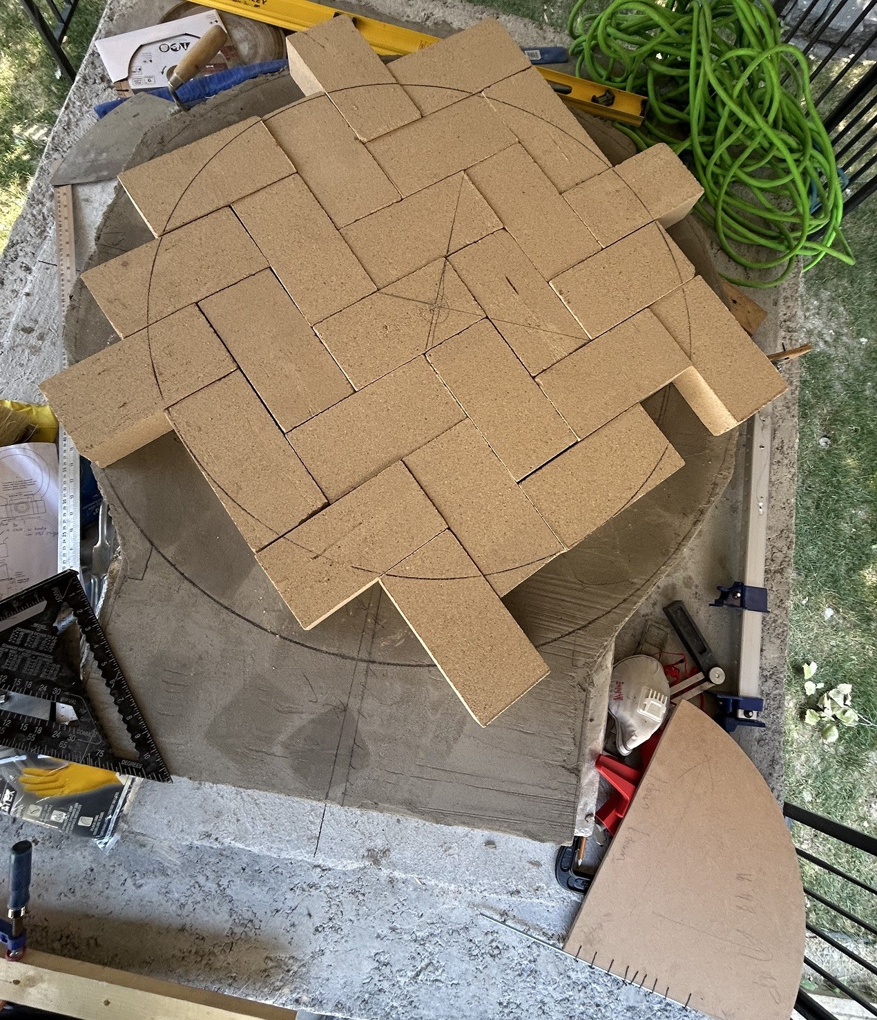

                  • A 50/50 mix of fine sand and powdered clay produces less movement than sand alone because the clay fills in the spaces between the the sand grains.
                    • did not need any, though I have huge quantity of grog from wet saw cutting of bricks I could used that, shims and so on. I found the bricks I had are two, one is thickest and one that was squeezed in factory that its thinner a tiny and excess is on edge (about 1mm). so I hand select bricks from my 188 bricks (I had 175 and bought extra 13) then using my laser level I tested each brick and the one that have same thickness as the hearth batch on hearth I used it. I then cut and dry fit, I also rounded the edge of the dome bricks first (course #0), and most importantly I washed thoroughly all bricks from cutting debris and let them now set somewhere to dry (not on oven insulation). I also had the edges of each hearth brick grounded (smoothed out) so it wont tear anything on it. next week most of moisture would have gone as its weather forecast is 33C tomorrow. moreover, I redraw the oven centre line correctly for the final hearth. here is the picture of my cut hearth, laid directly on Thermobond 915 coat with zero levelling:

                      • As you don’t actually have a soldier course (bricks standing vertically on their ends), the banding at the dome base is of little value, but if you are convinced it will improve your build, forge ahead. It also introduces the problem of anchoring the bands, particularly across the face of the of the oven entrance.
                        To clear up any confusion, the established terminology for bricklaying which has been discussed elsewhere on the forum is:
                        "on bond": bricks laid flat and subsequent chains staggered.
                        "soldiers": bricks laid on their ends, back to front (like soldiers on line up or drill marching).
                        " sailors": bricks laid on their ends side by side (like sailors lined up on deck)

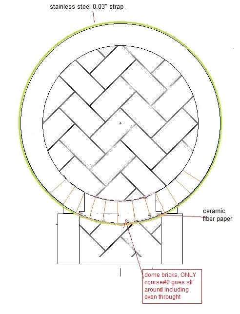

                          the course at level 0 which will have banding, will be full circle 360 degrees including at oven entrance . Its approximately same level as hearth and I will adjust the bricks of that course#0 at entrance to be at hearth level if I find necessary , the banding will be around them too. the clip that holds a long strip of banding is on the outside so it does not effect gap between hearth and dome course#0. I rather think, the banding is very important, while the outward thrust is not strong, having a banding that is snug and adjusted after first firing will help keep dome in perfect position and prevent cracking a bit. I show below an illustration:

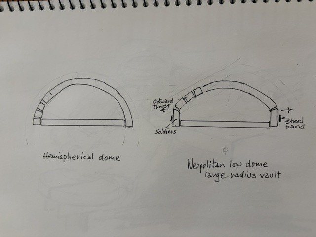

                          • Over the last few thousand years, the most popular all round oven form has been the hemisphere. It has of course advantages and disadvantages. As a combustion chamber it has no competition as the auto industry also knows, Its advantage in building, as eons of Ancient Roman architecture shows, is ease of construction, utilising a semicircle and employing the self supporting qualities of the form which do not require (or minimal requirement) for buttressing or bracing. Although thermal expansion and contraction really test this quality. As a baking oven its circular floor makes loading difficult and tall baking pans cannot utilise the perimeter because of the dome vault being in the way. The Neapolitan oven, developed in Naples to increase output by higher temperature employing a low dome, which creates greater radiant heat because it's closer to the food, works well to cook food fast. Unfortunately the price it pays is reduced structural integrity because of the much greater outward thrust created by the expanding larger radius vault. The method used was to get height at the perimeter by using a soldier course and steel band to counteract the outward force, rather like a tight belt around the chest which restricts easy breathing.
                            The attached drawings should explain all this better.
                            In the case of your oven as your course 0 is not actually in the chamber, those bricks will not be as hot as those above them and as they will be restricted by the steel band, will result in plenty of stress between course 0 and course 1 which is not restricted, but expanding more. You will have to wait and see how it works, but I fear there may be a problem at the mortar joints between these two courses.

                              There will be no stress between course#0 and #1, the reason is the stainless steel banding will be only tightened while the oven is hot, so after first firing when the oven fully cured and reached its final highest temp and before putting the dome render insulation, the band will be tighten, carefully , and lightly, while the oven is still hot, which means fully expanded. therefore no stress on any other than the expected between any two brick joints. regardless if its full sphere or not, there is always a thrust at joint , either fully downwards(course#0 bottom) or fully horizontal (at pole) and 1/2 in each direction at 45 degrees joints, the stress is always there however the shape of the brick and its rigidity as well as mortar flexibility will prevent any cracks:
                              1)my course#0 will NOT be mortared at bottom,only joints, so it can slide
                              2) banding will be tightened only once while oven is at its hottest
                              3) I will apply on the outer most edge of course#0 brick faces where it meets the insulation coating a thin layer of refractory mortar to seal the render ceramic fibre mat dust from entering into cooking chamber. because brick will expand on the inside face as its hottest, it will move inward toward dome centre than outwards, therefore a thin layer to close any gaps on the out will either never crack or if it does will be easy as its too thin to prevent the movement of dome

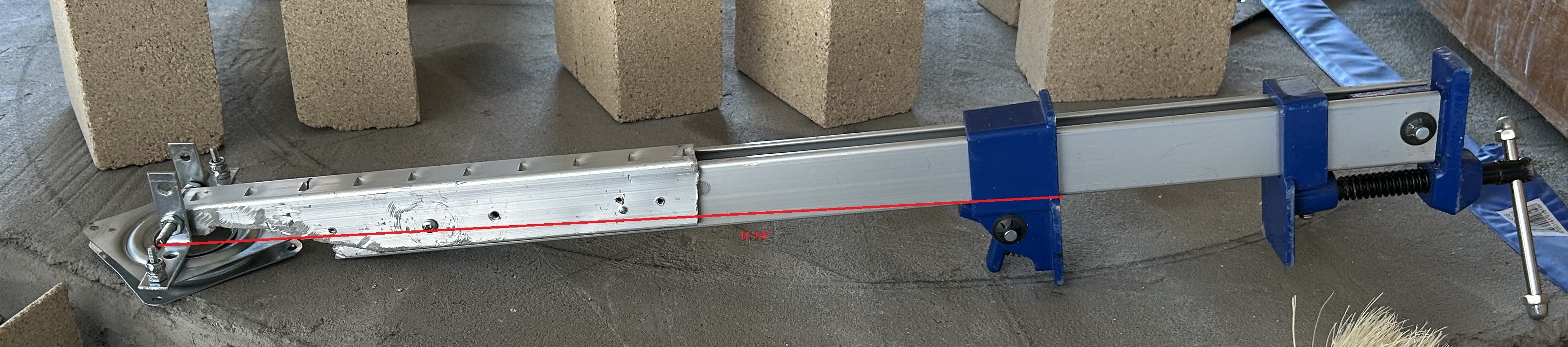

                              • I had lowered my indispensable trammel tool axis even more, after I finish assembling the hearth, I will try to confirm it can fit above insulation with little shims, and if it works then I will create a wooden brick to hold it otherwise will have to lower the axis even further.now the top of the brick will be very very close or even lower than where all axis meet so may even have it closer to hearth than before, going to test it on real radius on oven to figure out:
