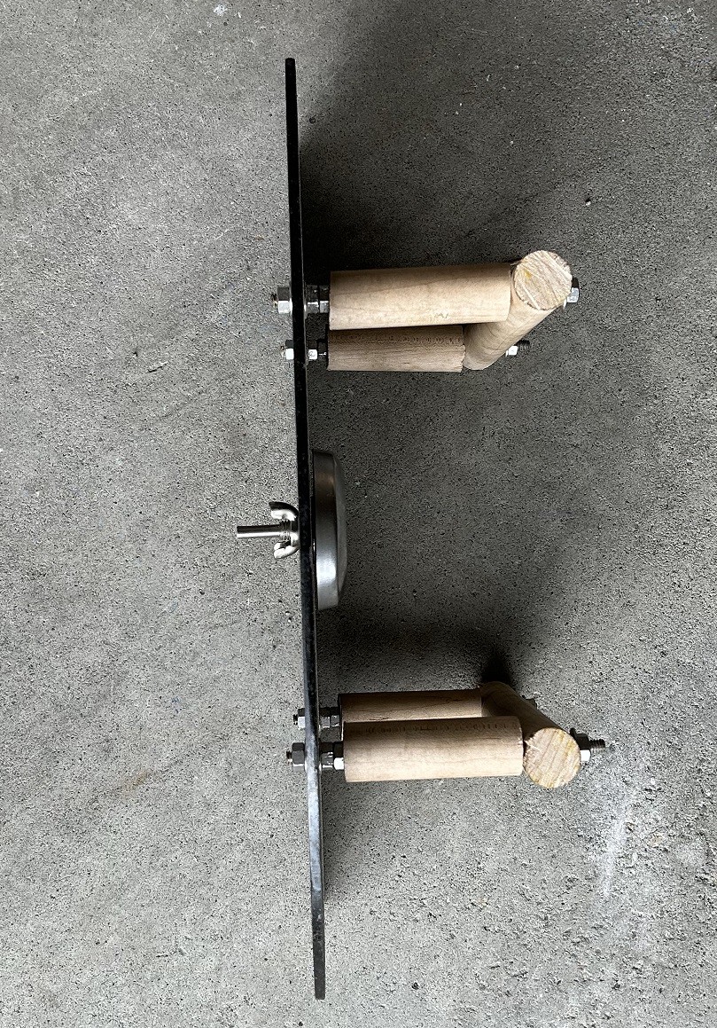

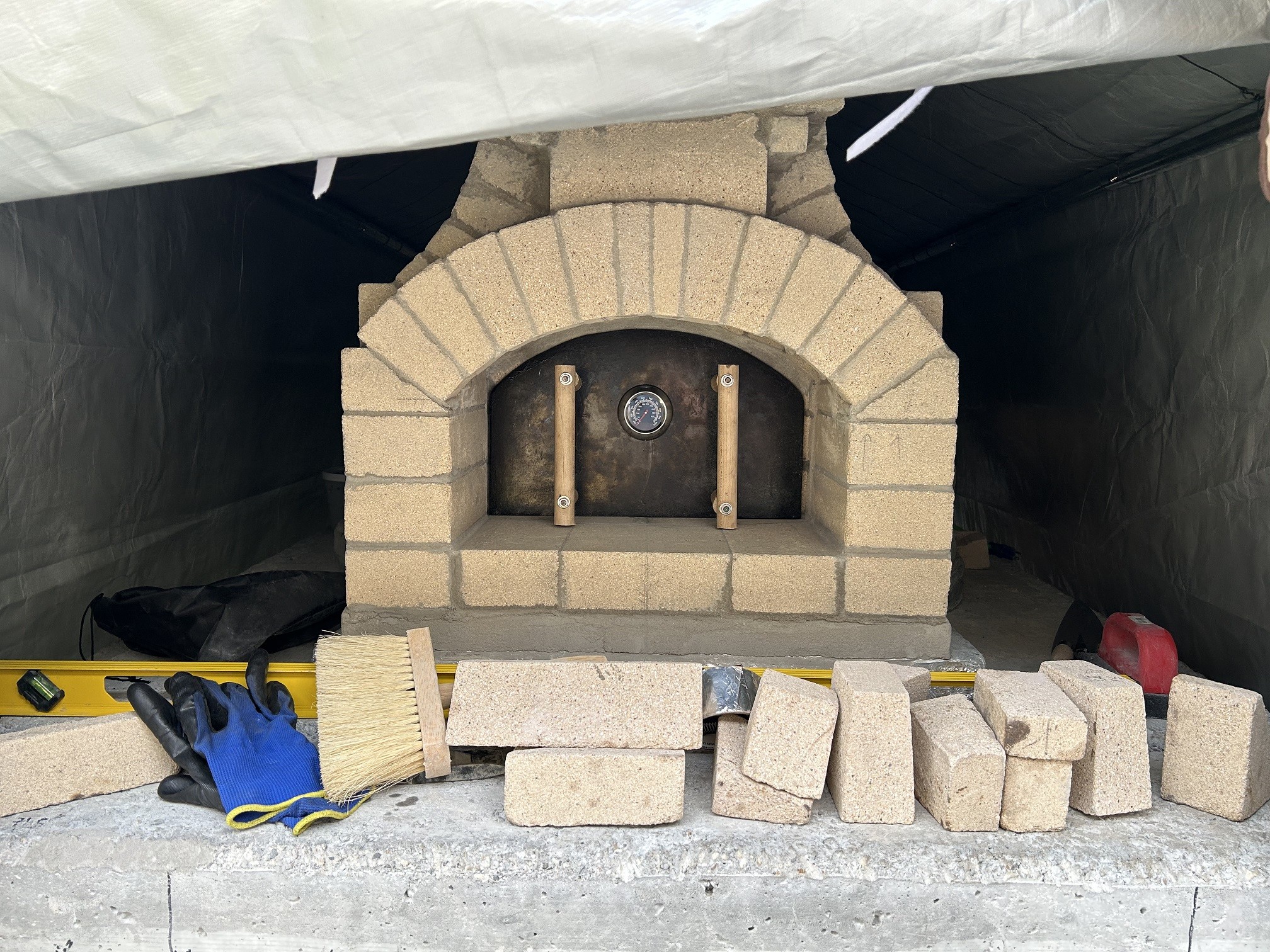

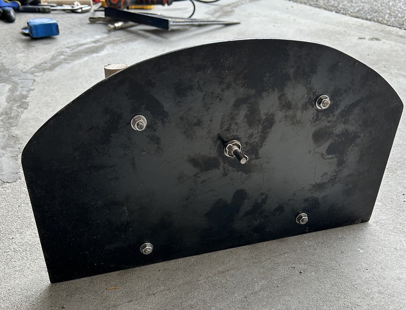

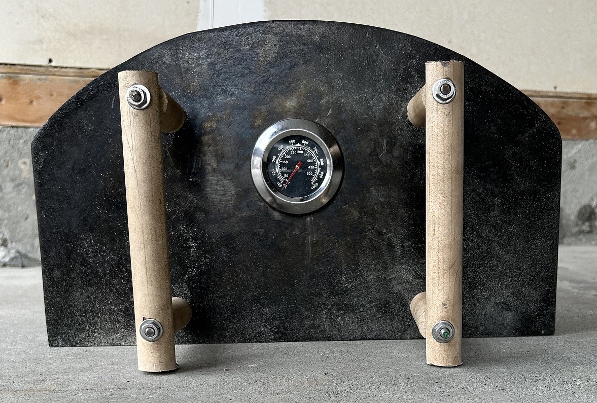

              I today assembled the steel door using maple dowel to create the handles, bare without any insulation and will likely use it as is for a while. for now, it will close the oven and prevent insects and rodents from nesting in it over winter. I got other things to work on next spring. I rather spend some time making sturdy all metal Andiron, log management stick... and so on on top of oven pending work:
              0)close cmu block vent using stainless steel mesh and mortar
              1)create dome buttress and arch buttress, use concrete vibrator- keep oven dry, cure
              2)install chimney and rain cap with spark arrestor, re-level base adapter first as it might settled during long winter freeze
              3) adjust door for tight close using fibre glass gasket or refractory mortar, put mortar on all inner arch lining except floor, then with little oil on door=> close it plumb/vertical and hand vibrate until it creates a matching surface => then gently remove to create a perfect matching other face after it cures
              4)insulate dome with ceramic fibre blanket, also archway( last chance to install thermometer probe )
              5) fire cure the oven slowly while dry
              6) adjust dome banding tension while oven is hot, keep it snug while hot
              7)apply perlite cement render
              8) cure again for the perlite render
              9) apply water repellent breathable paint/ protection/layer
              10)create and install aluminum roof shingles roof dome, should be strong to withstand snow and ice
              11)put granite counter tops for landing
              12)stucco and water proof concrete base, cmu walls, and top slab against rain, snow, and ice
              ​and here are the last pictures of this year, will continue the build next year:

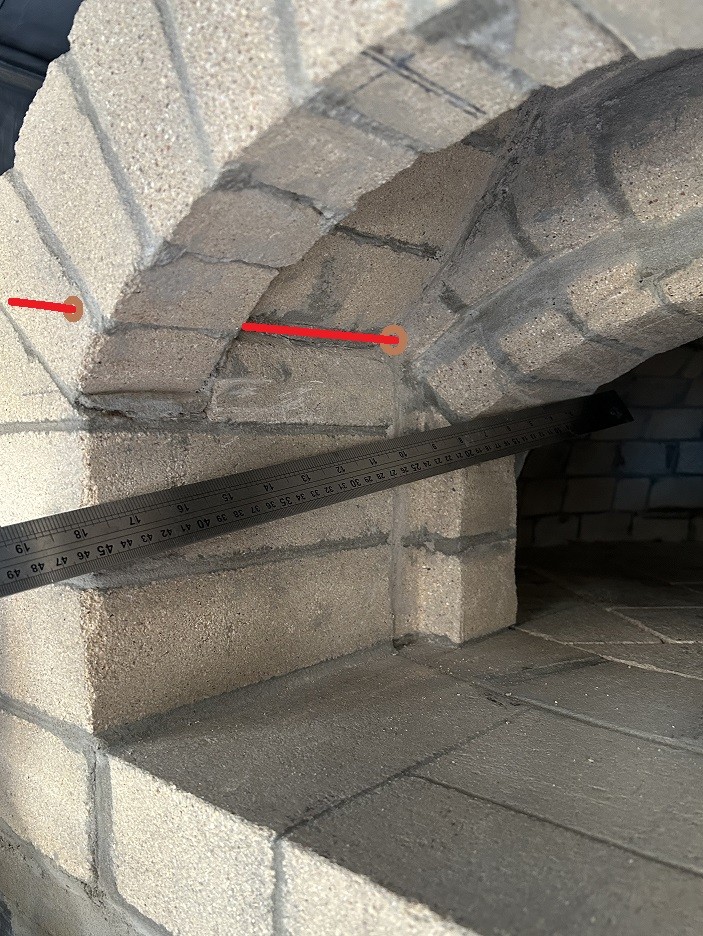

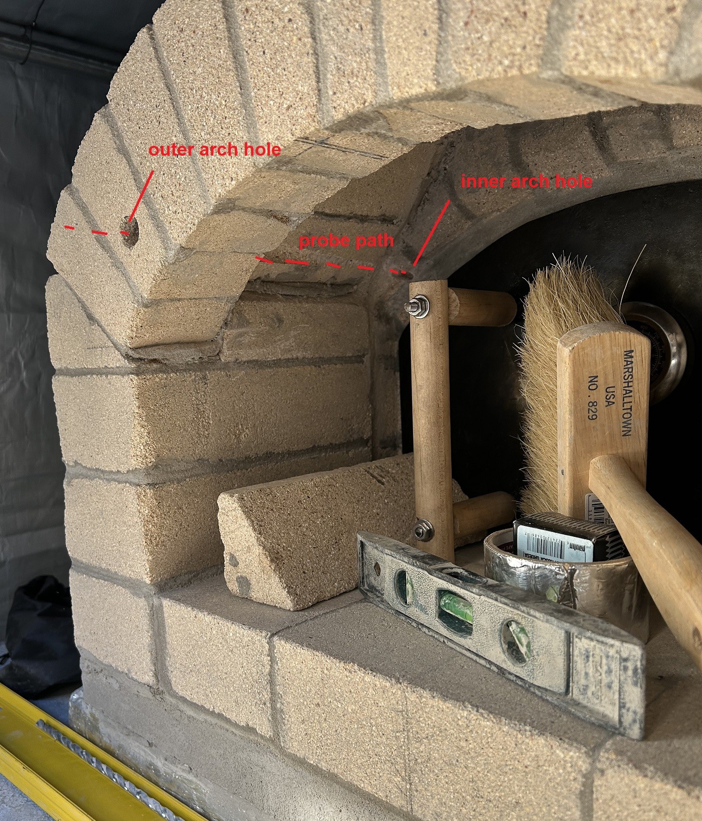

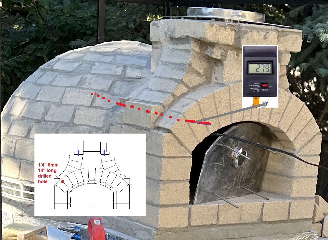

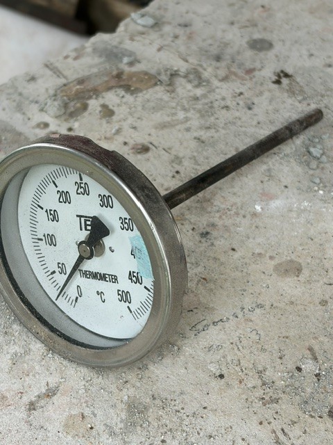

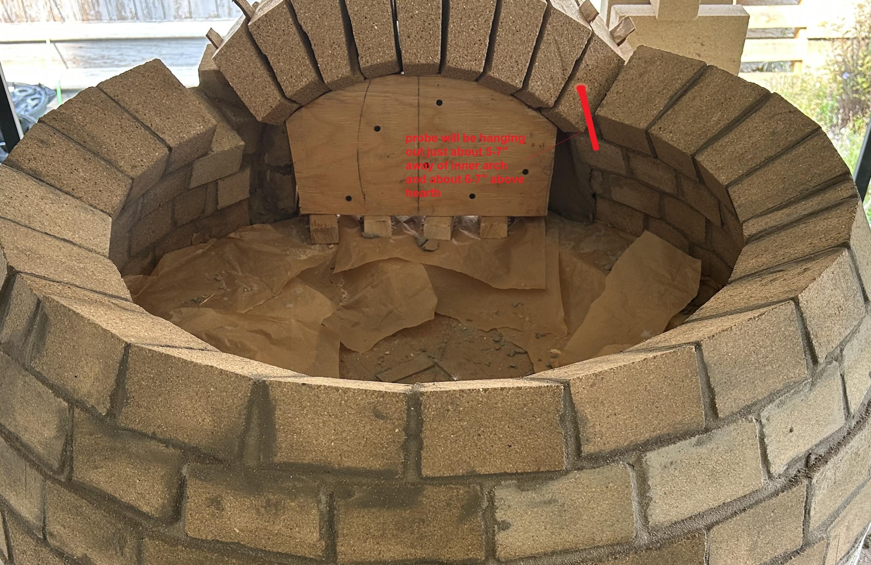

                    after long thinking on how and what best way and product to installing a permanent thermometer that measures pizza cooking temperature, I landed on a K-type thermometer with probe. I avoided thermo well ones because they require large diameter hole, ceramic fibre insulation, and likely will stay at least 1/2" away from the brick surface as the hole if penetrated into cooking chamber could leak air/heat, or fibre dust interchangeably with render . while using infra red thermometer satisfies the basic necessity of knowing the temperature, I chose not to depend on it because if I am cooking rather have something else hold the thermometer for me. so the design that have the following features :
                    - can be removed and replaced any time plug-and-play
                    - simple and cheap
                    - accurate and reliable
                    - high heat and temperature range
                    - can be removed completely if needed one day
                    is a K-type very long thermo couple probe and reader such that the probe will penetrate the outer arch, pass through the flue gallery arch, and into the inner arch and then extended hanging out into the dome few inches to be just where a thermometer probe tip need to be facing the exact flame and air that the pizza will sit under. leaving 1mm extra gap in the drilled hole, a 1/4" (about 6mm) hole allows a 5mm stainless steel sturdy probe to be inserted without the need for any ceramic fibre paper insulation or whatsoever as that path is a smoke exist and with inner arch throat opening of mine is 14 3/4" x 8 7/8" , that gap is almost nothing. even if oven door is closed, the leak from around the door seams is probably much more.
                    I therefore loved that design and purchased the following:
                    - 5mm (diameter)x 500mm long probe that can measure from like -40c to 1300C (not F, its Celsius) , food safe , stainless steel
                    - reader , digital uses 9 volts battery with plug that can be easily plugged or not any time just like any household appliance (I purchased two so if one fails I got another)
                    here are the pictures and the plan, any thoughts? I feel very excited about this design as I never seen it but I think it should work (picture position of probe and reader are approximate and suggestions, not final or accurate, just for illustration of the design):
                    Click image for larger version  Name:	1.jpg Views:	0 Size:	288.1 KB ID:	473606
                    Click image for larger version  Name:	2.jpg Views:	0 Size:	345.5 KB ID:	473607
                    Click image for larger version  Name:	3.jpg Views:	0 Size:	761.5 KB ID:	473608
                    • IH123
                      • May 2026
                      • 134
                      #205

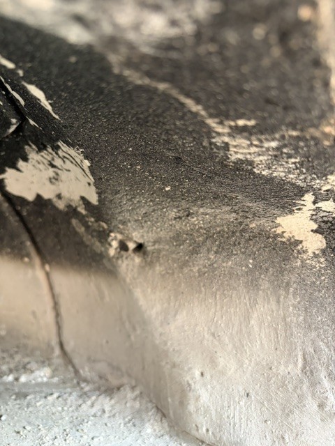

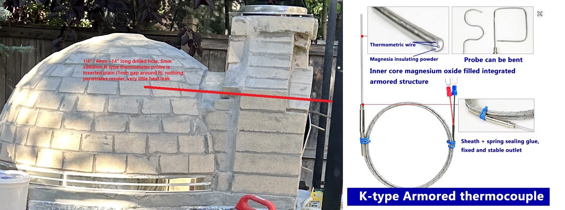

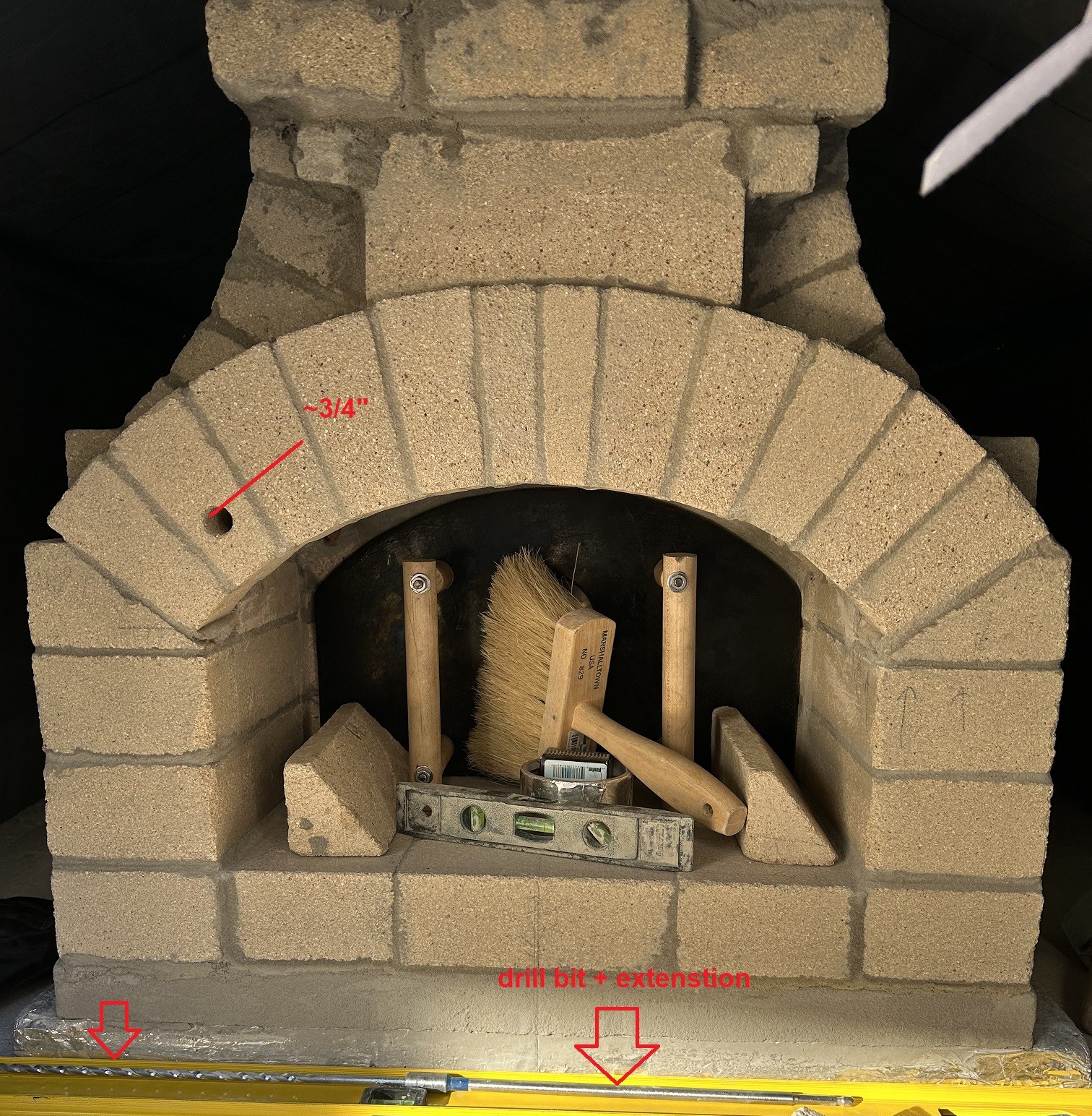

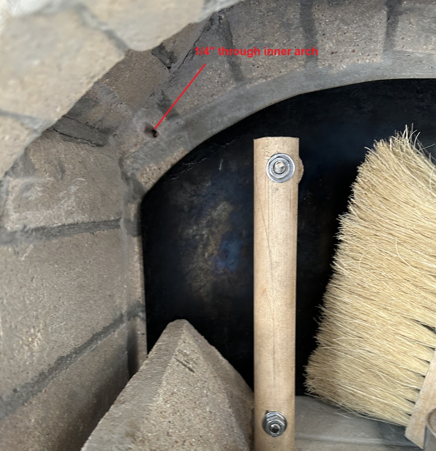

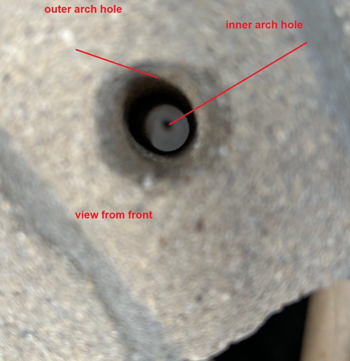

                      here are the drilling I made:
                      special tools:
                      -BOSCH BM2008 1/4"X13" Fast Spiral Rotary Masonry Drill Bit
                      -BOSCH Daredevil DSBE1012 12 in. Extension
                      - 1/4" masonry bit 4" long
                      - 1/2" masonry bit 6" long (wiggle it to achieve about 3/4" diameter or use 3/4" if availble)
                      process:
                      1) locate a path where the hole won't exit the dome to outside, ends inside the cooking chamber, and be not in flue gallery way, as well as in a position (depth and height) near where pizza will be put
                      2) drill the outer mouth arch on determined position with the 1/4" x4" bit, then use larger bit (about 3/4") to make it big enough for the extension tip to slide inside
                      3)use the 13" drill bit to drill as much as possible into the inner arch, a 1/4" hole
                      4) attache the extension cord and drill bit together (total is about 23" long ) and drill all the way until drill bit exists into the cooking chamber, repeatedly pull out to extract brick debris as needed as it could jam from too much brick grinds that it won't drill if not cleaned
                      5) vacuum all the debris using shop-vac and a brush
                      when weather is above freezing at night (in summer) :
                      1) fill the outer arch 3/4" hole (3" long) with refractory mortar
                      2) slowly insert the 1/4" drill bit , turn the drill bit one turn every 30 minutes or so until it comes out clean turning the 3/4" diameter hole back into a 1/4" hole
                      3) after it cures, re-drill with the 1/4" bit to ensure enough uniform diameter
                      4) insert the probe (50cm) all the way without any insulation or wrapping, a ~0.7mm((1/4" hole - 5mm probe) / 2) gap all around is enough for expansion and has negligible heat loss or air exchange
                      when my probe is delivered in next few days, I will post pictures of it
                      ​pictures of the drills :

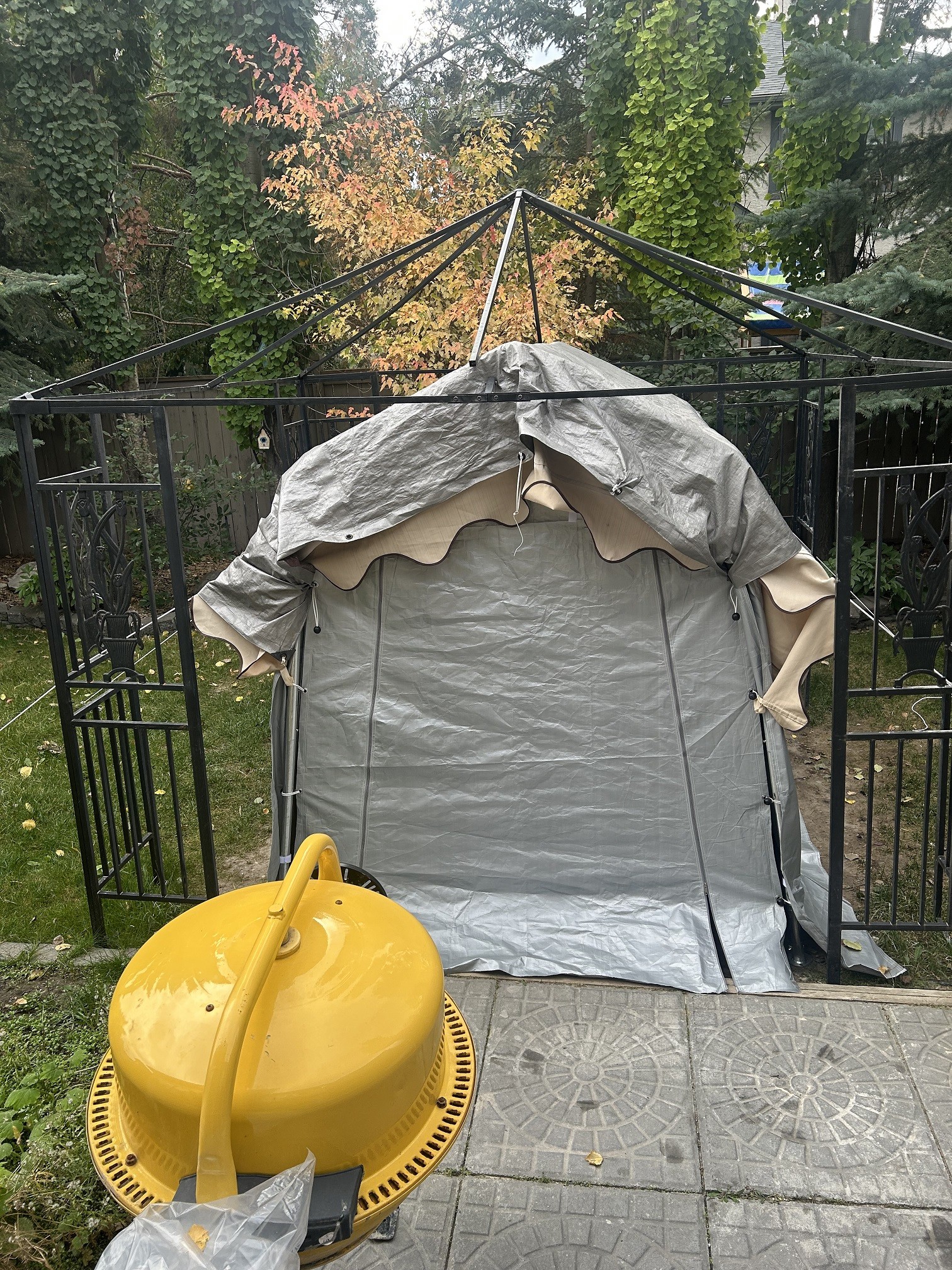

                      Click image for larger version  Name:	Untitled.jpg Views:	0 Size:	23.1 KB ID:	473717
                      Click image for larger version  Name:	IMG_0010.jpg Views:	0 Size:	882.3 KB ID:	473715
                      Click image for larger version  Name:	IMG_0011.jpg Views:	0 Size:	653.2 KB ID:	473714
                      Click image for larger version  Name:	IMG_0012.jpg Views:	0 Size:	337.5 KB ID:	473713
                      Click image for larger version  Name:	IMG_0013.jpg Views:	0 Size:	933.9 KB ID:	473716

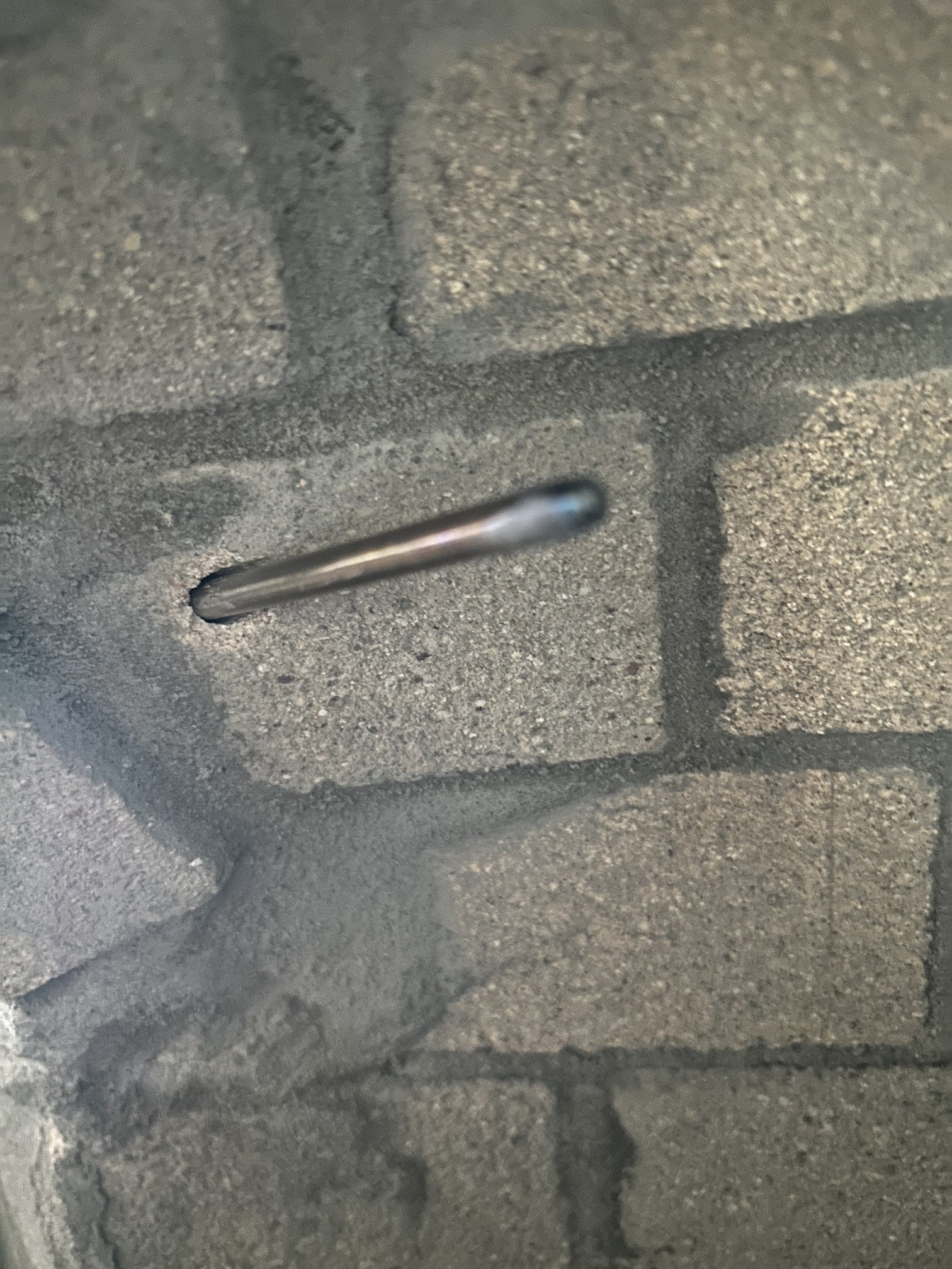

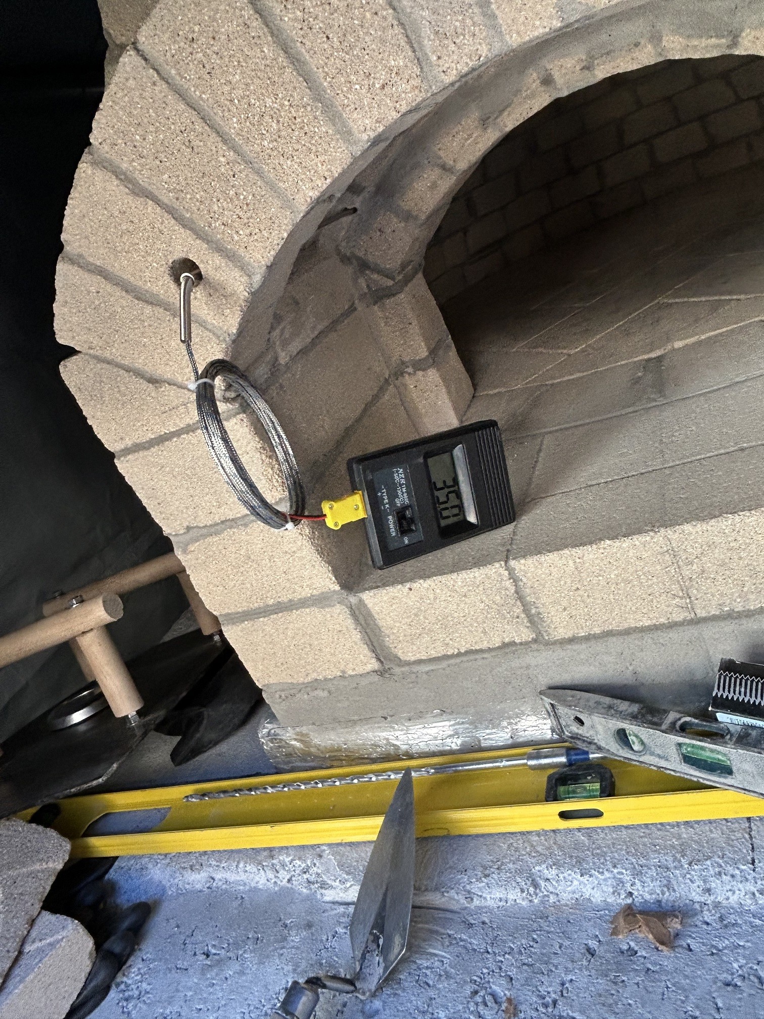

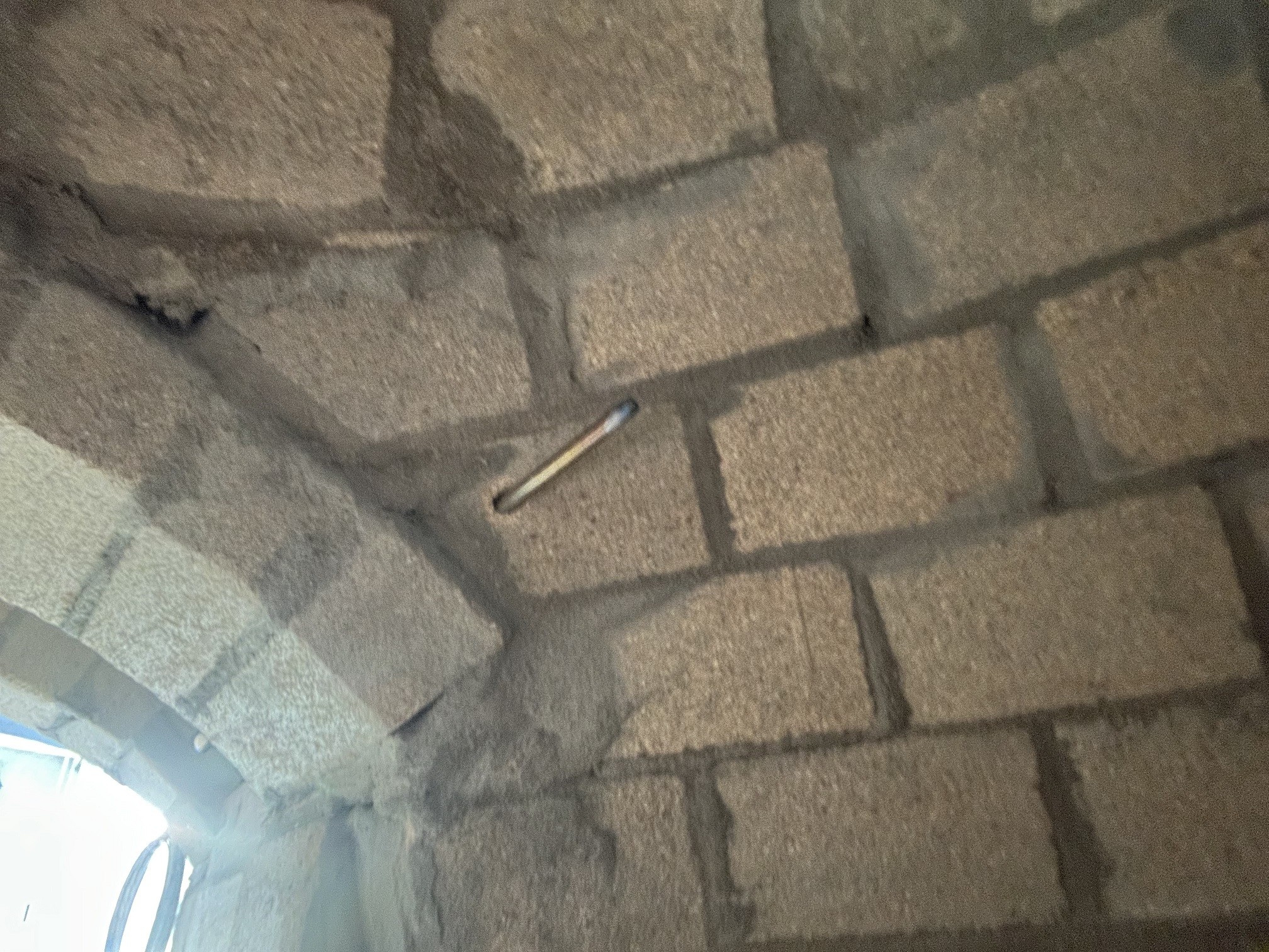

                        I received the 50cm thermocouple probe and tested it up to 650c on gas flame , I then inserted it in the oven like if its in final position, there was only about 2" inside the dome air and everything else past it is in brick so I am thinking of getting another longer probe (they have 1000mm ones), only after I try the 50cm one on real firing compared to infrared one. The internal brick temperature might provide a correct reading better than a transient flame or flash of hot air deep inside:
                        Click image for larger version  Name:	IMG_0038.jpg Views:	0 Size:	1.14 MB ID:	473791
                        Click image for larger version  Name:	IMG_0044.jpg Views:	0 Size:	1,017.1 KB ID:	473792

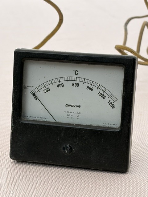

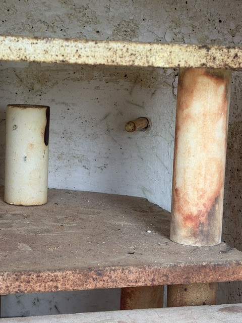

                          K type thermocouples, the most common type, are primarily designed for higher temperature applications like kilns and furnaces, with components that are tolerant for service temperatures more than double what we require. They therefore are usually more expensive and are usually provided with a porcelain sleeve to protect the inner wires and require penetration into the inside of the chamber of around 50mm (pic 2). So to use one in a WFO makes it vulnerable to damage from tools and bits of wood frequently being poked into the cooking chamber. The principle is that as heat passes from one metal type to another a small electric current is produced, so connection to a sensitive voltmeter can be easily and accurately calibrated to read temperature. Earlier versions (like the one attached pic 3) from the 1970s, which require no power for their operation, have now been replaced by ones with digital displays that make temperature increase and decrease rates instantly indicated as the numbers roll over and can also be programmed and coupled with an electrical control for heating element energy input. These digital display units do require either connection to power or a replacement 9V battery. Over the years, just as all electrical equipment fails, I have replaced two of these digital display units for kilns, yet my trusty, ancient, unpowered analogue display unit still operates flawlessly and it's the one I use for my current kiln.
                          Installing a thermometer on my first mobile oven (first pic: probe without sleeve), I selected a thermometer with a capacity to 500C and decided to protect the probe with a 1/2" copper tube, the point of the tube and probe flush with the inside surface of the inner dome. It worked well, but kept on pushing the read out display and probe out of the dome a few millimetres for each firing. When it had pushed it out by about 12mm, I concluded that it was the expanding copper sheath, firm in the hole when cold, gripping tight onto the surrounding refractory of the inner dome as the inner dome itself expanded, consequently pushing the probe and display out past the outer shell. On removing the probe and enlarging the hole slightly, I replaced it and had many years of trouble free operation. Lesson learned, don't have your probe too tight in the inner dome hole.
                          Most oven owners are pretty obsessed with temperature, but become far less so with experience. I find the best indicators are the black carbon burning off the inside of the dome (300C) and a hand held to the outside shell. In addition I sometimes use a cheap bimetal oven thermometer that can be placed in the centre of the oven to read air temperature exactly where you want its measurement. Meat probe thermometers are also very good, measuring the temperature inside the roast.IR temperature guns, while accurate can be quite misleading when used for cooking because they are reading the surface temperature and give a wild variation of readings depending on where the temperature is shot.
                          Wood fired ovens are really quite forgiving regarding temperature, I think primarily because they cook using radiant heat.
                          Hope this helps.

                            #208
                            There is no other probe or thermometer that can measure up to 1000F and is long enough to be inserted all the way from the mouth and into the throat of the oven other than K-type (two metal) probe:
                            1- analogue ones have short probe , can't be used in archway. while I could use a thermowell, with thermowell hole stops about 1" before dome cooking chamber , I'd rather not as the thermometer itself has to pierce into the render and dome insulation and actually costs a lot between stainless steel well pipe, probe and insulation and so on.
                            2- I bought my probe for just about $23 CAD including shipping directly from China, the LCD display is about $7 CAD including shipping - the cheapest it could get for an industrial scale thermometer
                            3- The method of inserting the probe through the oven's mouth-archway is very clean as at any time or even moment, I could just pull the entire thing out and replace it even if I am cooking without having to change anything in the oven. thus I can clean it from carbon build up, the fact it can withstand 1000c means any build up can be burned out (cleaned) using a simple flame
                            4- there is no need for porcelain/ceramic wrapped probes, it will unnecessary increase the diameter without adding rigidity (metal is stronger) , and it could shed hazards into food cooking area. the k-type probe is of stainless steel casing so its inert food wise
                            if anyone is interested I can share the link of where to buy.

                                #210
                                Originally posted by david s
                                That sounds like a logical solution.
                                I've always installed thermometers from the side which reduces probe length and keeps them out of the way of the front of the oven.
                                For my current mobile oven I selected a thermometer with probe attached to a wire about 800mm long,so I could have mounted the analogue display dial anywhere, but with the tip of the probe set a little loose and flush with the inside surface of the oven chamber about 1/2 way from its base (see centre of 3rd pic). Purchased on line, I can't remember what it cost.
                                Click image for larger version Name:	IMG_2581.jpg Views:	0 Size:	109.6 KB ID:	473853 Click image for larger version Name:	IMG_2583.jpg Views:	0 Size:	64.2 KB ID:	473854 Click image for larger version Name:	IMG_2584.jpg Views:	0 Size:	91.6 KB ID:	473855
                                very cute oven . If you close the hole where the proeb erects into the cooking chamber with a tiny bit refractory mortar, wouldn't that prevent exchange of hot gases between the dome render under insulation and the cooking chamber, or you left it exposed intentionally? I can't quiet tell from the picture if the probe (whether its in thermo well or not) , has punctured all the way until inside of the dome inner or not:
                                1- if the hole punctured all the way until the inside of the dome, regardless if its with thermo well or no, there will be exchange between the air /moisture under render above dome brick and the inside of the dome hot smoke air that insulation fibre in tiny quantities could leak into cooking area and moisture could accumulate a bit more into render (while fire bricks are porous and would release moisture , the hole would provide different passes of the flow
                                2- if the hole stopped about 1" before it punctures the dome inner, then it should be safe
                                if the probe does not get exposed directly to hot flame then its response will be slow as it dampens by the brick thermal conduction.
                                That's why I avoided this case, although its used by many professional oven makers. The probe I inserted from the mouth is not in the way of anything as it goes very flush with the flue gallery arch legs. the only place where its out is from the dome inside about 2-3" and outside the mouth however it could almost be never touched by anything as its in the front of the oven where there is no access from the back of the oven to reach it in the front and nothing will curve from the front door backwards ,in a hot oven, to touch it when its that short.
                                probably my saying here about your mobile oven is not relevant as the holes are very tiny and temp fluctuations are of insignificance in a wood fired oven where warming up takes hours and flame cooking dominates , however since in my oven case I am doing the first oven and first thermometer, I had chosen to avoid any exchange between dome render and cooking chamber. I will see how it goes when I fire the oven next year summer.
                                while the oven is in active firing, the exchange of gases between dome render and inside of dome (when probe is inserted like the one on your mobile oven) may be insignificant however I feel that after active flame is put off then there is not much pressure for steam to exit the dome brick upwards however the thermometer probe hole could let lots go out (no evidence, just assumption) , which could lead to humidity moisture accumulation in any perlite-cement render instead of existing through the mouth
