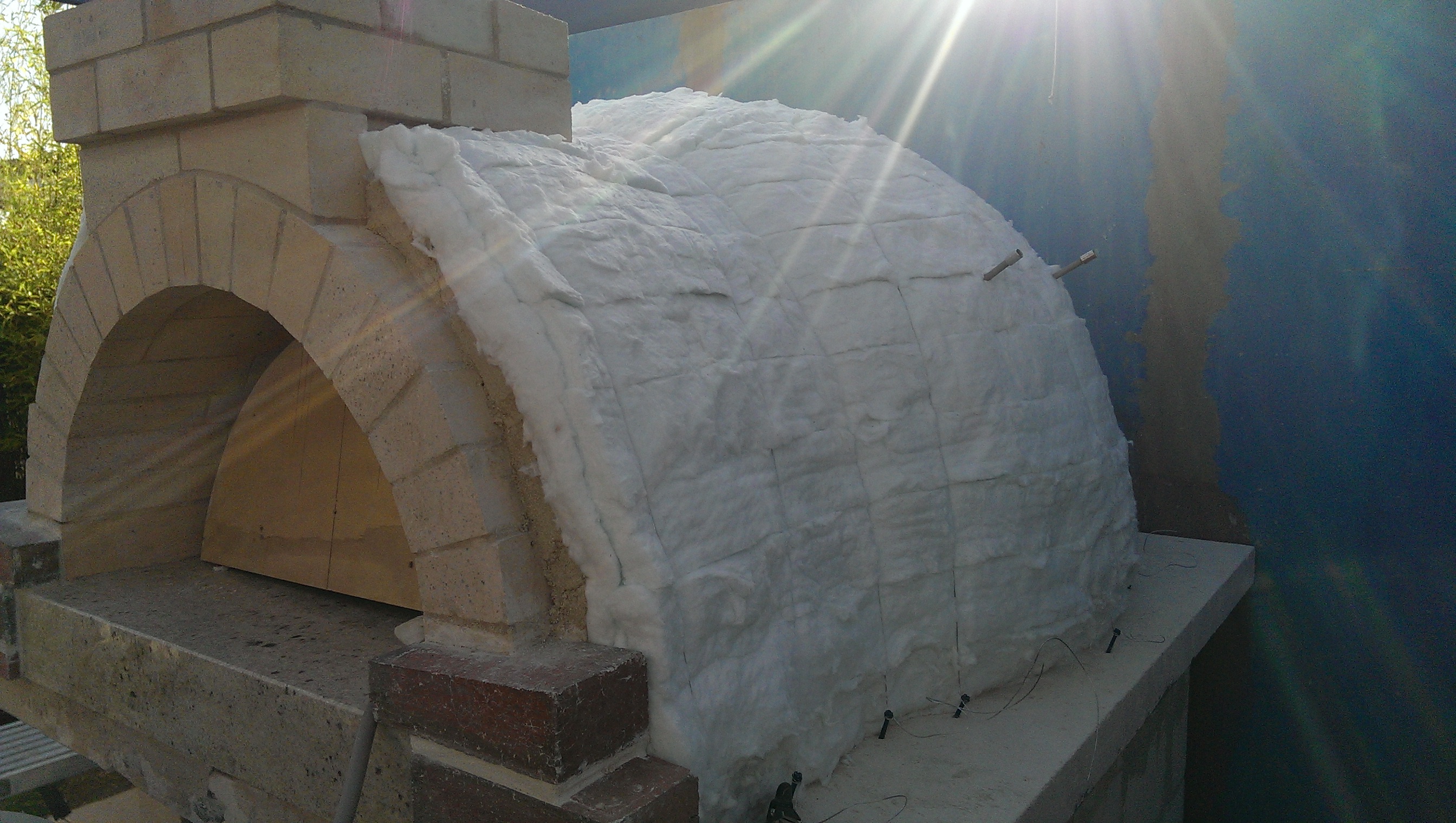

    and the conclusion to the end of the dome. Curing blanket layed, God shining down from above pic 4. All that's left is the render purchased this today 10 bags not expecting it to be enough but will get it close.
    looking at 50mm of render based on most recommendations,
    Look like you have God's Blessing, you must be doing things right.
    Keep up the good work.

    well I got the insulating blanket on the dome. BEen firing it all day 3 rings, temp around 330c top of dome wals not far below 180c and owe r down the dome.
    the thermocouple positions ar great. reading 180c 10mm from the internal dome surface and about 120c 10mm into the fire brick.
    so far so good. The blanket at the top is actually feeling a little wet.
