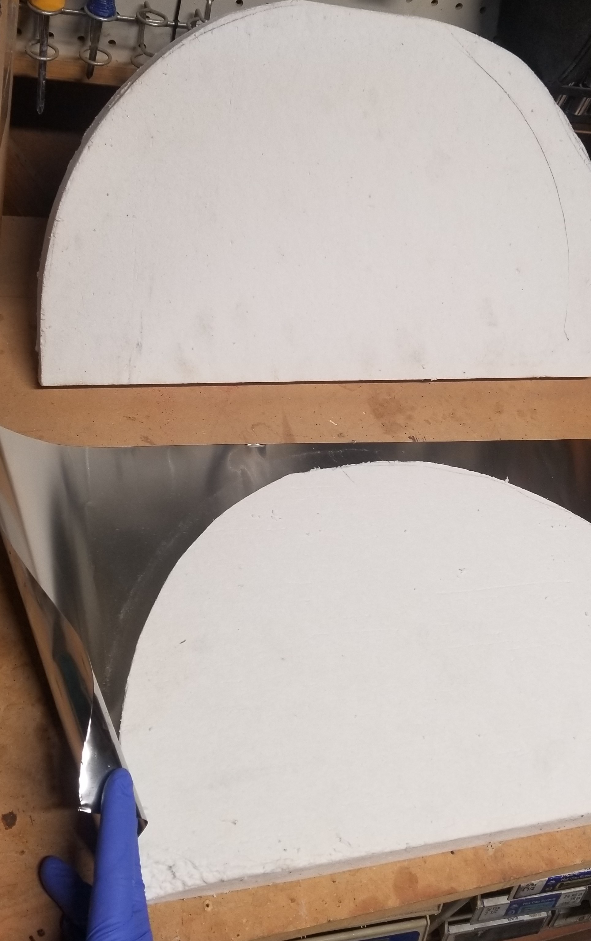

    Hi folks
    I am going to try and build door out of two 1" pieces of CaSi board wrapped in .002" 304 stainless steel foil. I will cover all exposed edges of the CaSi board with the foil and glue it on with Rutland metal-to-masonry furnace cement. I plan to add an oak or walnut backing to the entire assembly. I may also add a thicker plate of stainless for the bottom portion of the door which contacts the brick floor. Here is a pic of the foil and both CaSi pieces. What do you guys think? Is there another adhesive that you would recommend for attaching stainless to CaSi and CaSi to wood? I will post again once I start putting it together.

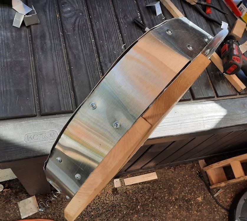

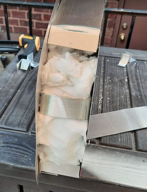

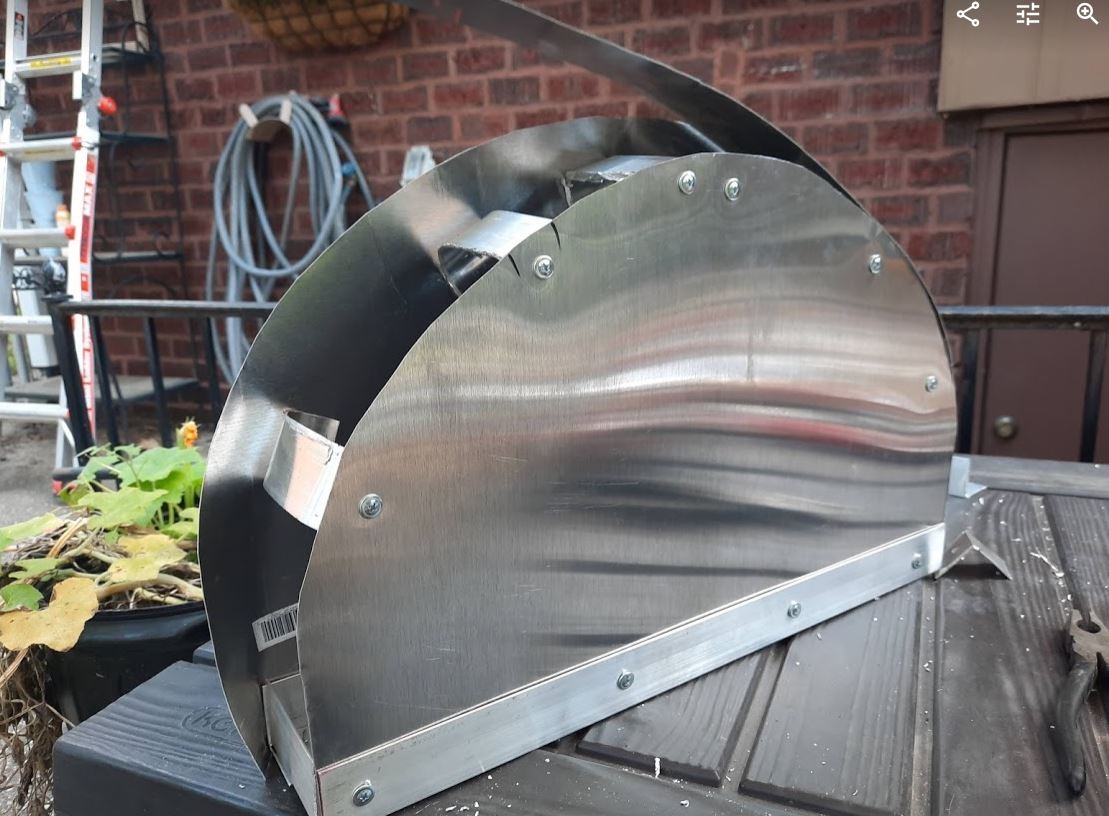

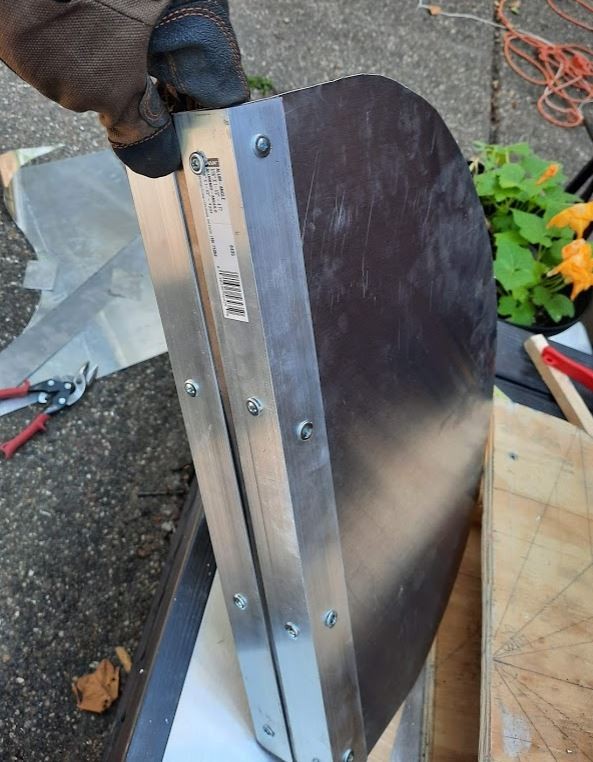

  • plastered
    replied
    My sloppy non-weld door based on Greenmans build -- The only thing I'm worried about is the ceramic fiber blanket pokes out a little bit in the corners, since my cuts and bends were poor. Cost me about 80 dollars for the aluminum sheets, sheet metal screws, and angle. Weights about 10 lbs. Took me a full afternoon to build. I wanted wooden handles but the Lowes I went to didn't have any, and I was impatient.

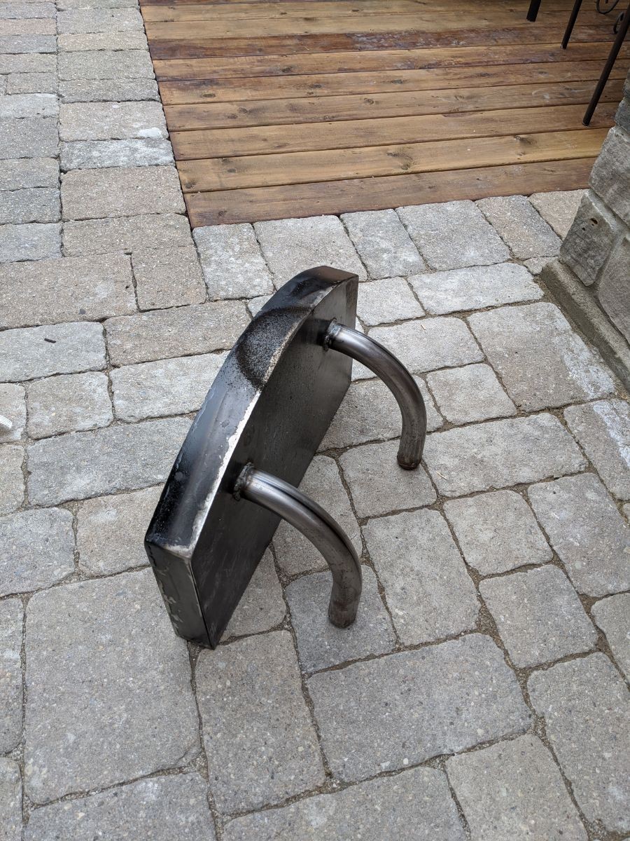

  • Mongo
    replied
    Metal door!
    The dude that made this builds race cars. Very talented.
    There's 3 inches of blanket inside. Used it for the first time last Saturday night after a pizza fire. Works like a charm.
    The handles are replacements for concrete floats. Bolted to nuts that are tacked onto the backside of the front plate. Thanks to JRPizza
    At baking temps we will still use the wood door. Lighter weight so my wife likes it better.
    Leave a comment:
