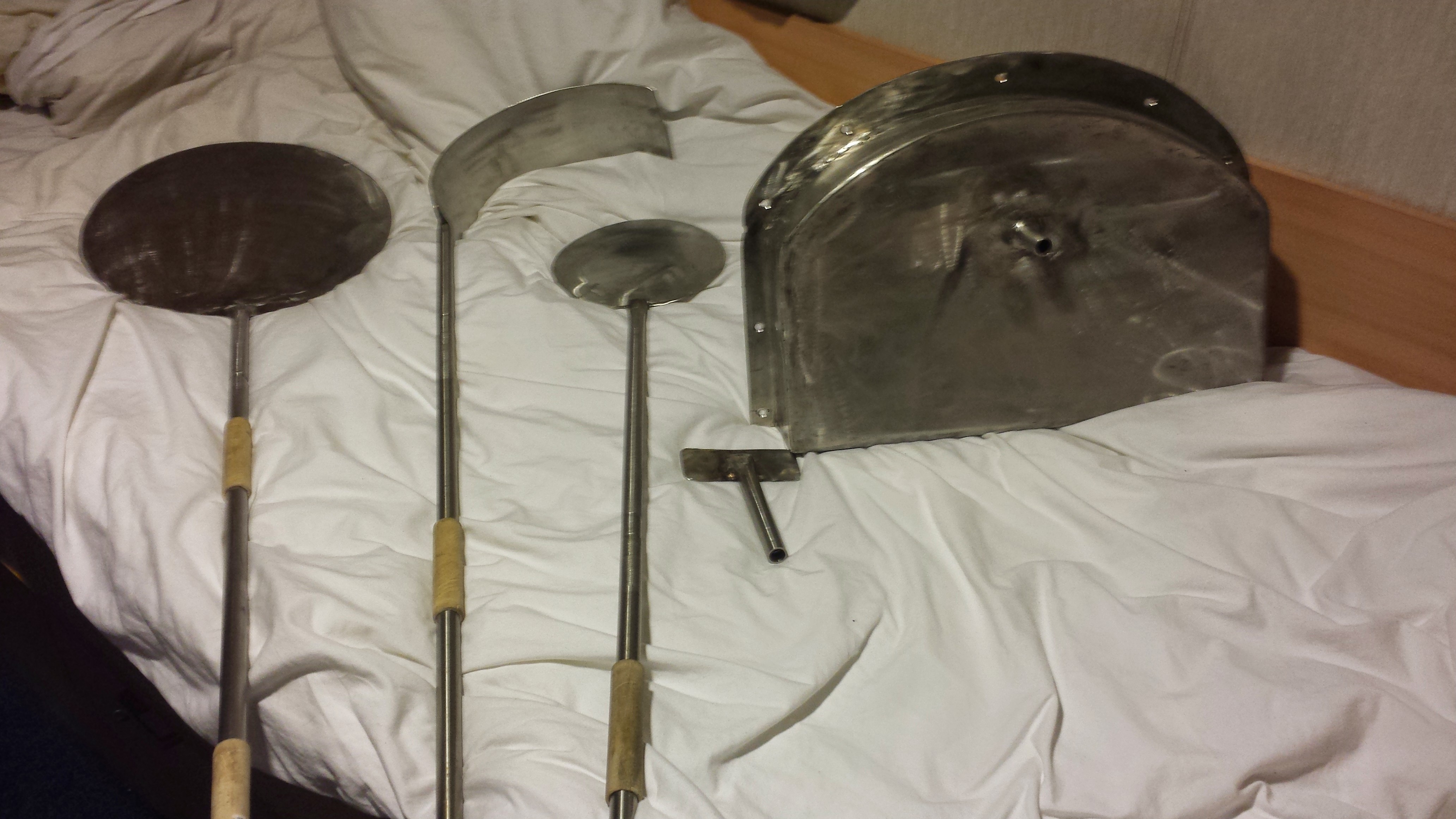

  • pikemonkey
    replied
    Re: Show us your Door Thread
    Originally posted by mikku
    Nice job with the doors and tools. you have a lot of talent working with metals. I went to a woodstove shop and bought rope designed as a seal for wood stove doors. Also bought some adhesive for gluing it around the perimeter of the door. So far it has worked great! Put it on sometime last year and shows no sign of wear or deterioration. The rope comes in a variety of sizes, don't remember what size I chose but it was pretty inexpensive--about $9.00 per meter. The cement was air set/heat set adhesive black good for temperatures up to 2000 F. My door looks like yours, has ceramic fiber inside but only about 2" thick. I still can remove the door without special gloves when the oven is 300+C.
    Thanks for your comments. Closer up they're not perfect, but functional.
    I have done similar as you describe with the rope seal and black adhesive.
    The larger diameter stuff is twisted stove rope, but a!so has another set of strands wrapping around it to keep it all together. It is this that has broken down, causing the rope to fray everywhere. It should be good for 500 degC, but I might try some thinner stuff without the wrapping, or stove tape.
    Not needing special gloves to remove my door but the handles fitted are too small to get a good grip. Thinking of buying a couple of cheap brick trowels and using the handles from them so they are open at the bottom if you get my drift.

  • pikemonkey
    replied
Name:	door and bits.jpg
    Made mine from stainless steel.
    It's a 3 1/2 inch thick shell, now packed with calsil and vermiculite and backed with some old T+G oak floor boards.
    Also managed to make a couple of peels, an ember rake, and a bracket for a wire broom.
    the handles are all interchangeable, and can be screwed into each other depending how long you want them.
    The door is heavy though, and so far I've used 16mm fibre glass stove rope as a seal, but this is falling apart after a few weeks use - any better ideas would be welcome for this.
    Leave a comment:
