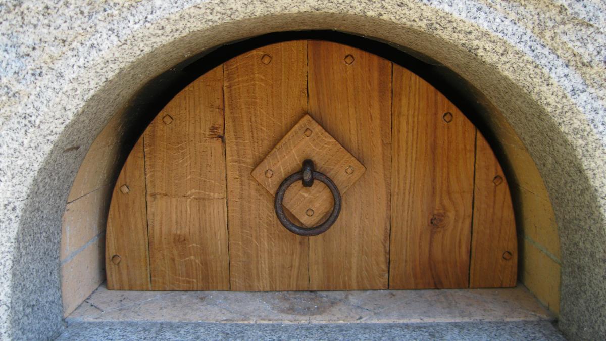

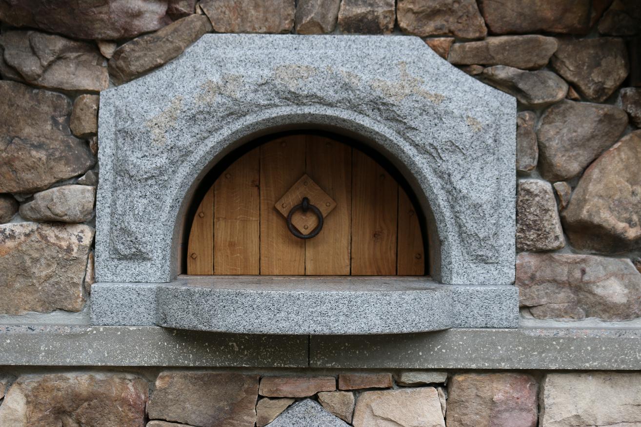

    I don't do jealous but I do admire the workmanship and the resulting granite arch. Gives some of us something to aspire to. Very special.

    Some cutter love the granite decorative arch I'm very jealous, that's amazing
