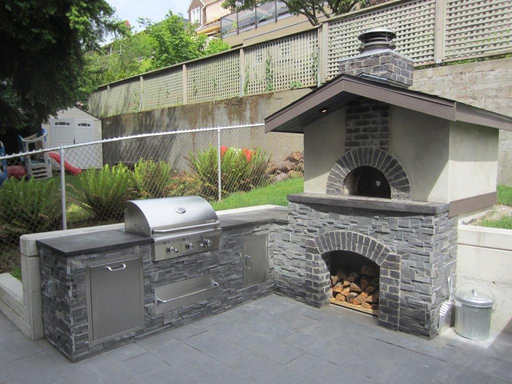

I got the last bits of touch-up paint onto the oven and power-washed the patio last week. With the stretch of nice weather we are having here in Seattle, I was finally able to get some higher res shots of my 100% complete oven and kitchen
Total time elapsed on the project was about 15 months - but I took about 6 months off for the winter. Total budget was about $8.5k, but more than half of that was for the shiny stainless bits and the barbeque. Thanks to everyone for their help and guidance along the way. I'm looking forward to getting a lot of use out of this in the coming years.2 Photos

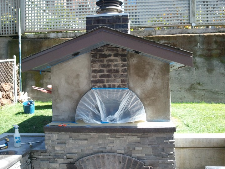

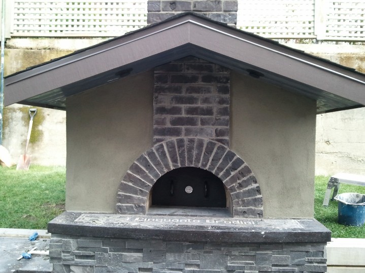

Got a bit more nice weather, so I was able to finish the stucco. Yeah! Now it's just a bit of quarter round trim in the eaves, pea gravel around the base, some cleanup - and I am off to the "what's cooking" section full time.
Here's the housing pre-stucco, all taped off because I make a mess with a trowel
90lbs of stucco mix - probably 30lbs more than I needed. But it comes in bags that size.
And the finished product
And just because I have one picture left - here's the baguettes I made yesterday! They came out pretty well for my first try - but I think I needed my oven a bit hotter because the crust wasn't as golden as I would have liked
