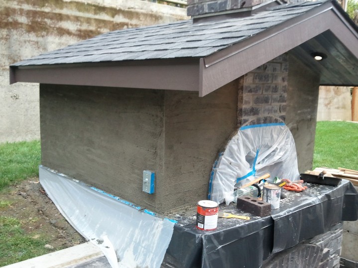

Got the brown coat all on today. Cleaned up the brick on the arch and chimney. I think she's looking pretty good! I kind of like the taupe shade of the wet brown coat, but SO says something lighter.
I'm headed to the concrete supply tomorrow to look for acrylic final coat + coloring.1 Photo

The guys i hired for stucco used the cement based mortar for scratch coats and then used synthetic (acrylic) like brickie said. The builder supply place where i bought it said "nobody uses real stucco anymore for final coat." fwiw The stucco guy agreed and said the synthetic is better and lasts, and easier to apply.
It was an El Rey brand and you can pick the texture and color to your taste.

I am 1/3 of the way through the brown coat on my oven house. Again, it is not as bad as I feared. I am taking it a bit slow - going as far as I can with a bag of mortar each day. Masonry experts, please tell me if I am making any huge mistakes, but let the little ones slide. I used s-type mortar for both the scratch and brown coats. Stuff that I picked up at HD that says "use for scratch and brown coats" on the bag. Hope this is right. Seems fine. I've applied about 1/4" for each coat. Takes about 1 + 1/2 bags to do a coat.
I do have questions about the final coat. What do I use there? Is there something with an additive that offers better water resistance? And what about pigment? Can I mix the color in instead of painting? Does that start with white mortar so I can do lighter colors? I haven't really research yet, so thought I'd just throw those out there.
Hoping I can finish up by Thursday, I am having a bunch of the neighbors over for dinner Saturday to see what I have been up to so I'd like to get all the tools out of there for that.4 Photos
