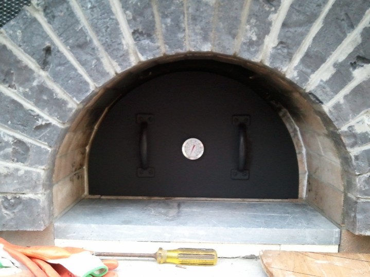

I think I am ready for turkey roasting!

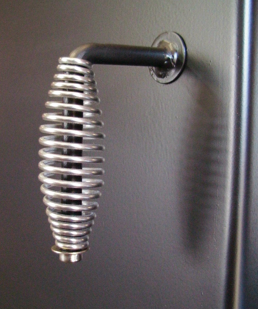

I bought a couple of gate handles at HD and screwed them to the door. Couple coats of high-temp flat black paint and the door looks all professional-like.
I am very happy with the fit. And it's only 10 pounds!
I think the oven being very hot and the metal door and the protected area of the flue arch all add up to heating the metal handles. Your milage may vary.
You will be surprised as to how much heat migrates to the front of the door and radiates off the front panel due to the weld connection. If or when I build my next door I will isolate the back from the front even more than I did the first time.

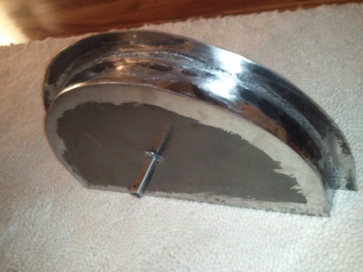

I have a door!
I had to learn to weld in order to build this thing. Those of you with mad welding skillz may find my efforts a bit amateurish (and I would agree they are). I bought a used HF 90Amp flux welder off craigslist and went to town. With the help of my trusty grinder I was able to get the thing looking ok. here's the details
- 16 gauge mild steel
- 2 inches of CF blanket as insulation
- Weight is 10 pounds, 2 oz
- High temp thermometer sourced from our hosts. It's mounted on a 5/16" nut welded to the back of the front plate. I was pretty proud of figuring that out.
- 1/4" of space between the door and the oven wall. I may get some CF rope to act as a gasket, we'll see how well it works.
It still needs a coat of high temp primer and high temp paint, and I need to figure out handles.
