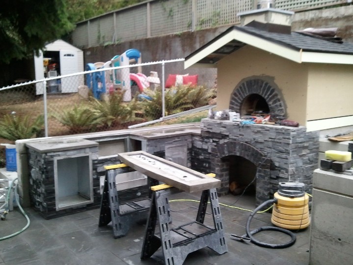

Here's today's view:

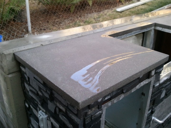

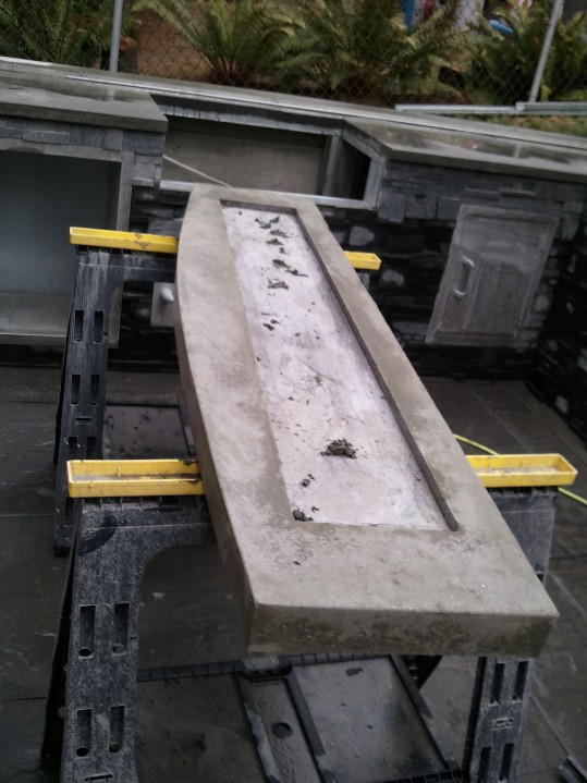

As you can see, the rain has started here. I got to this point just in time! The counters came out pretty well. As you can see, they're not exactly flat and water is going to pool in some places. Oh well. It's an outdoor kitchen.
I am pretty pleased with the results of the polishing:
I still need to stain and seal, but they're pretty smooth and I am happy with the way the aggregate exposed.
As you can see, I also started putting up the felt and the lath. I hope I did this right. I figured I would at least get that up while I think about the stucco application.
Today I'm going to clean up all the concrete dust and get the last cabinet installed. Be ready for beauty shots tonight
