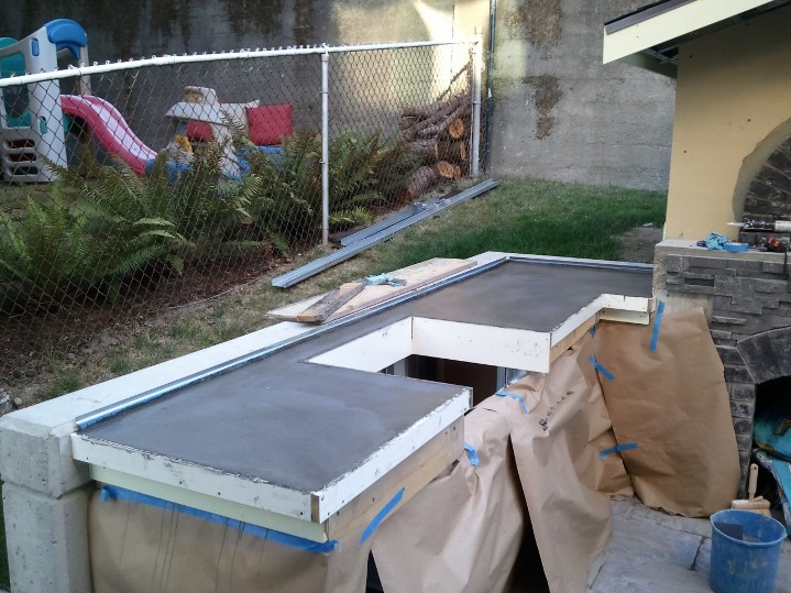

I got the concrete for the countertops poured yesterday afternoon! Well, more like "positioned" as the countertop mix is pretty stiff stuff. It would hold it's shape when dumped into the form out of a bucket. Very little slump! I tried using the recommended amount of water per the instructions (1g per 80lb bag) and it would not even mix in. I probably added 50% more water than called for in order to get it to mix with some workable consistency. At the end, I didn't have any water at the surface so I think it will be ok. I guess what I did was technically GFRC, since I used both fiber mesh and cut strands in the concrete.
The cast-in-place section went well. I hard troweled the finish and I think it looks pretty good. Where the concrete meets the existing wall, I used a piece of galvanized "z" flashing with some double stick tape as a temporary form to create a slot. For the final join, I bought some Schluter metal tile edging that will go into the slot created by the flashing for the finished product. I plan to secure it with Silicone Caulk. I did make a mistake with the pigment - adding only one of the ziploc bags to each batch instead of two. So the final product will be a bit lighter than planned, but I can live with that. It was also tough to screed the section, since there was no back wall - but I laid tape there as a guide before the pour and I think I got it pretty level. Passed the eyeball test which was all I needed

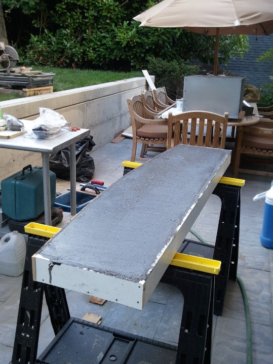

Pouring the precast section for the landing was super easy. Two bags of concrete, easy screed, and easy to vibrate the mix into the form. I did not use any aggregate in either section - but in this one I decided I wanted to put a tile mosaic in front of the oven opening - so I placed a piece of ~4.5' x 8" x 3/4" piece of melamine inside the form to create a space for an inlay. It's going to say "I Cinquanta Passi" (Italian for "The Fifty Steps") - which is what I call my oven since there are fifty steps from the street to my backyard. The picture shows the bottom of the counter - and you can kind of see the grid from the Glass Fiber that I used for strength.
Looking forward to getting the forms off and the first pass with the grinder to see how things look.
