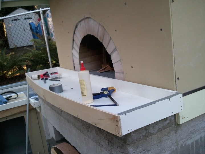

Re: Starting new 36" build
Hah! I was planning on following your lead! The landing is only 2.5" thick. Must look deeper in picture due to the forms. But it's still gonna weigh 200 pounds. Will be fun to flip and install!

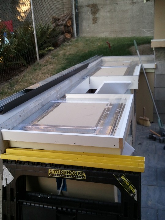

Forms, forms, and more forms
First, the archway form for the "faux" arch over my firewood area. The wood I'll use to jig the voisseurs and the corner pieces is shown for fit. Setting the columns was a total PITA but I think I finally got it right:
And the countertops:
And finally the pre-cast form for my oven landing. I have it sitting there for scale, but will be casting it on a table that has leveling legs
Hoping I can pour the countertops this weekend. But if not, I have the brickwork and then the stone veneer to keep me busy.4 Photos

I used the HVAC tape to cover all the gaps in the metal framing and around the concrete board. I probably didn't need it, but I had the time so I used it to seal everything up in the form. Figured it was the thing that would stand up best to the wet concrete.Originally posted by UtahBeehiver View PostDJ,
