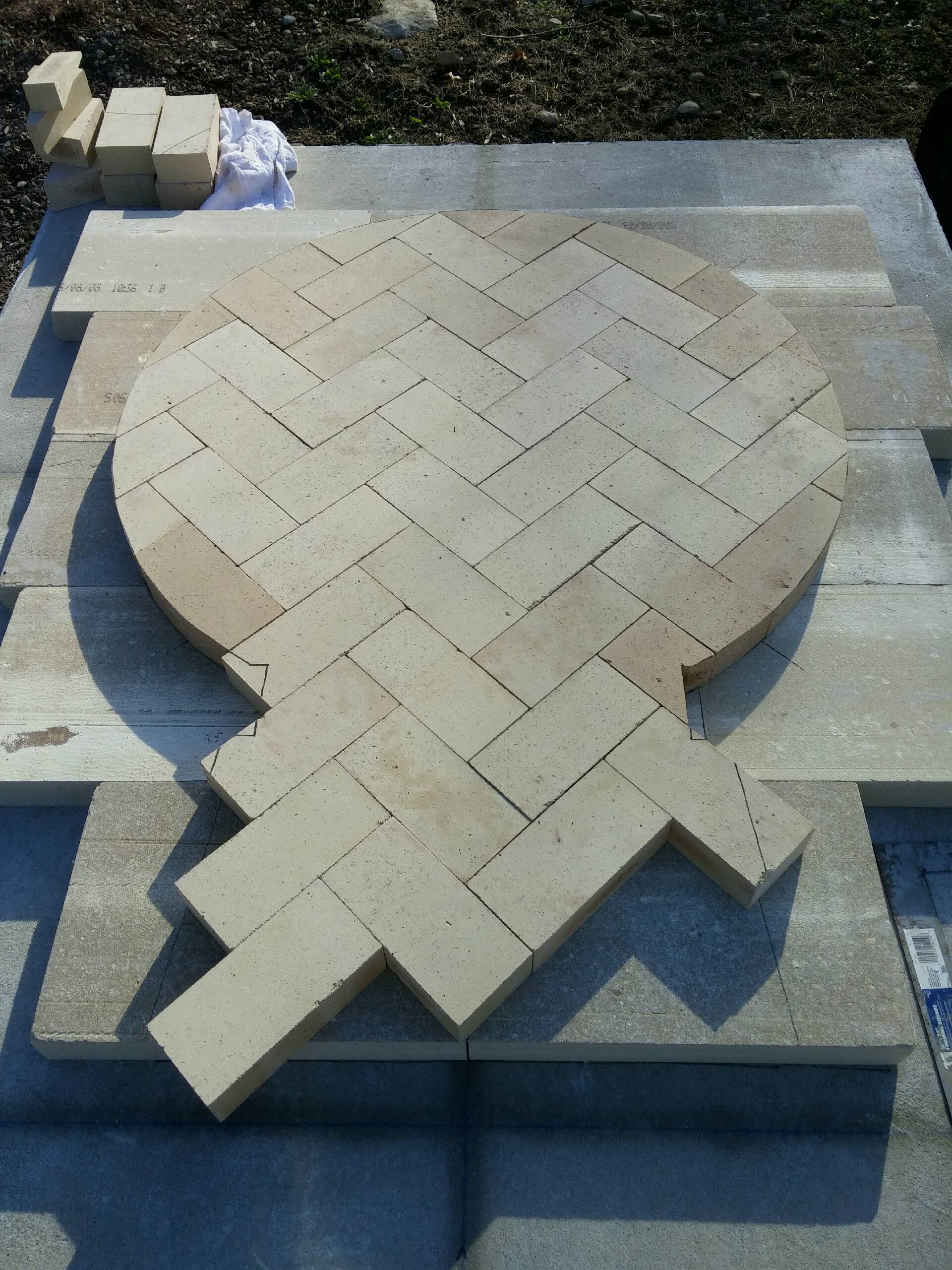

    [ATTACH=CONFIG]n387288[/ATTACH] I got a lot done in just a few hours yesterday, Insblock 19 is down and my floor pattern is almost complete, just have to get back to the forum is see where the herringbone pattern stops at the front entry or continues to the outer arch entry.
    Ivan

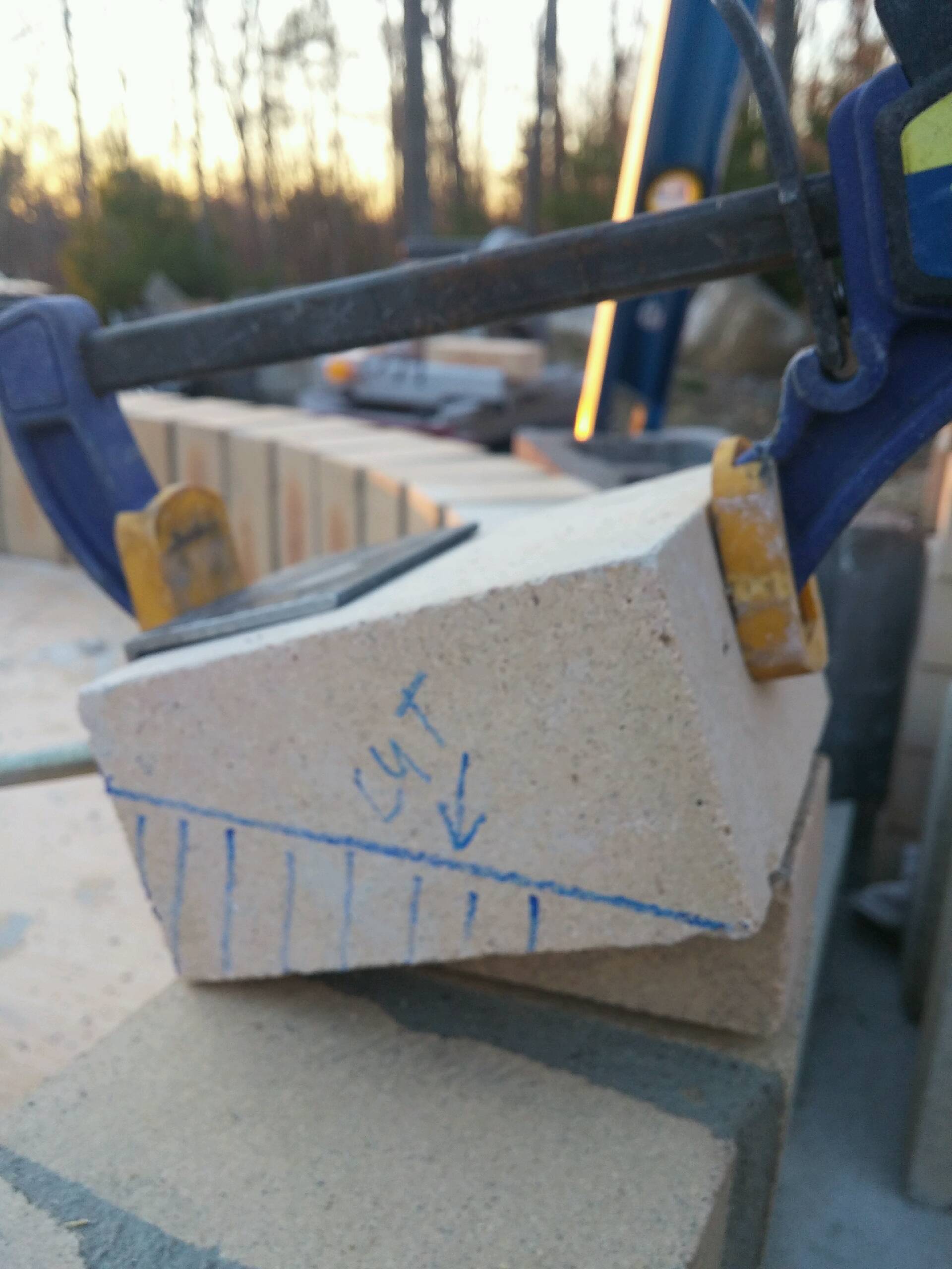

                [ATTACH=CONFIG]n387460[/ATTACH] [ATTACH=CONFIG]n387461[/ATTACH] [ATTACH=CONFIG]n387462[/ATTACH] Fellas I need help. My soldier course is done(no angle on top of bricks) and I dry fitted a half brick on my first ring and was surprised by the large gap of 1 3/8
                I uploaded 3 pics to ask for your advise on how to proceed.
                #1.Do I use a shim to pick up the space and fill with homebrew?
                #2. Do I cut the brick at the slope angle?
                #3. Leave it as is and fill gap with homebrew.
                Please chime in guys, I intend on starting mortaring tomorrow morning.
                thanks
                Ivan.

                  I have decided on my own to proceed using shims to fill in the large gap. I have searched thru other builds and could not find a clear answer to my question I posted above and no other forum members have
                  chimed in to offer advise as of this morning, I want to get an early start on my build. Hopefully all goes well. Wish me luck!

                    Ivan, sounds like you're already moving ahead, but I affirm the use shims and fill in with mortar. If you can plan how many courses you'll need (find one of the course/brick calculators on the forum), then you can figure out the approximate dimension for the width of the shim. I was able to use about 5-6 shims at a time, stick them in about 1/8-1/4" and by the time I laid 5-6 bricks, I could pull out the shims and use for the next bricks. Do not cut the individual bricks. You'll be there all summer.

                      I had a shim dimension of .7". I figured the circumference, subtracted the number of courses multiplied by 2.5" to get the amount of the circumference that would be taken up by bricks, divided the difference by the number of courses, and I had my shim dimension. Then I went and cut some shims with that dimension. Worked great.

                        I think people have done all of your options. I filled mine with mortar as I went and used a spacer to keep it all the same. For mine the fat end of a wire nut worked out just right. Hope that helps

                          I went ahead and layed my first course on a brick shim then gooped it up with homebrew,set my brick held by the IT tool and tapped into place, worked great for me. gastagg I just made a shim that would allow at least an 1/8 -1/4 mortar joint under the first course. The homebrew is great stuff almost bonds as soon as it touches brick, I used 3:1:1:1 mix with 2parts water.
