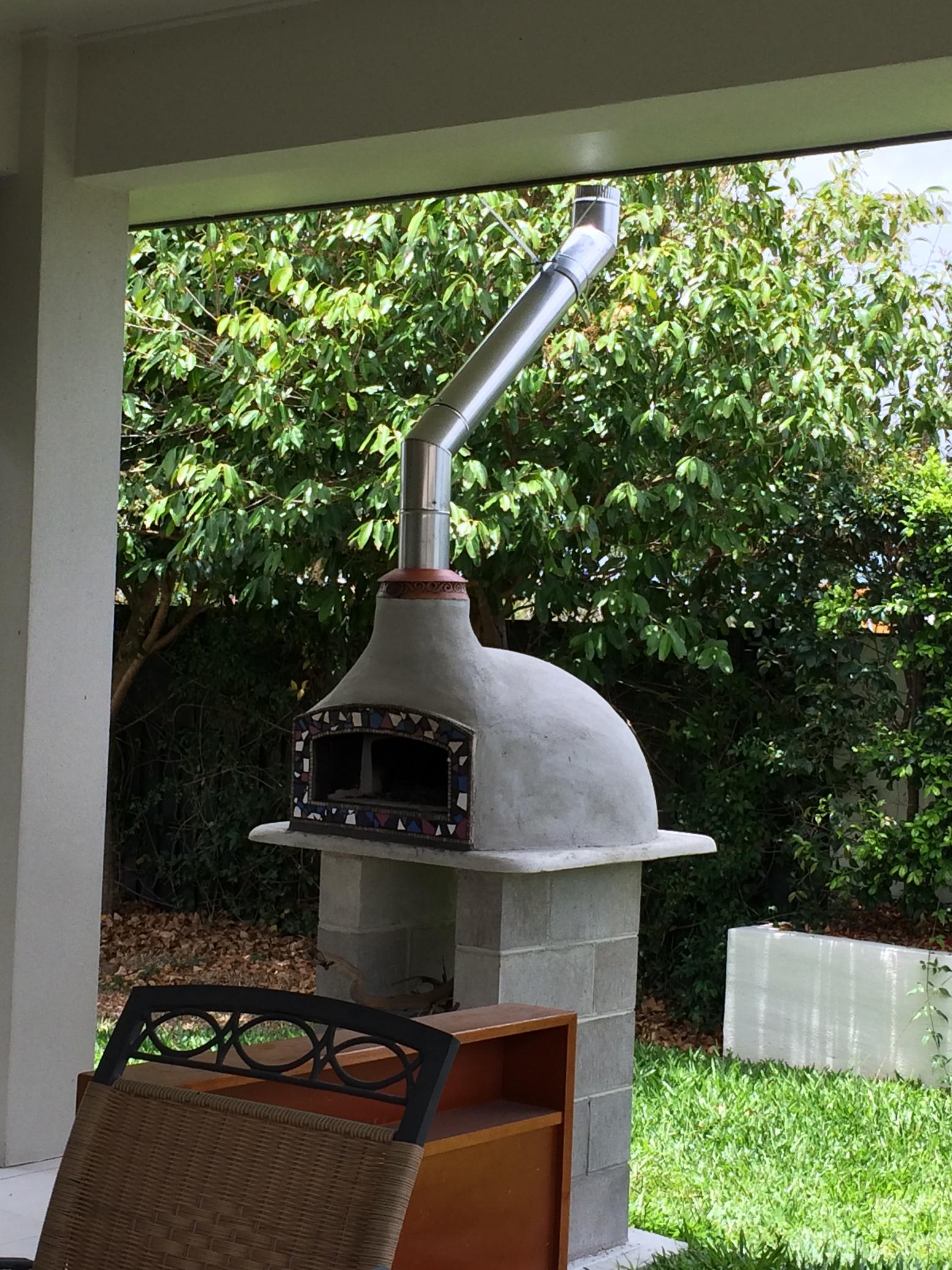

                            My daughter and son in laws oven (pic) fired their oven up a few weeks ago following our wet season when it's way too hot to be thinking about fires. Although the oven is totally undercover it still sucked moisture from the atmosphere into the dry refractory from our really humid weather. Consequently on firing the oven exterior was quite hot to the touch although it performed ok. It is the moisture that conducts the heat making the insulation less effective. I like to leave the door of the oven completely off when possible so air can circulate inside the oven. One wet season a few years ago I opened the oven and found mould growing on the inside of the door's insulation panel.
