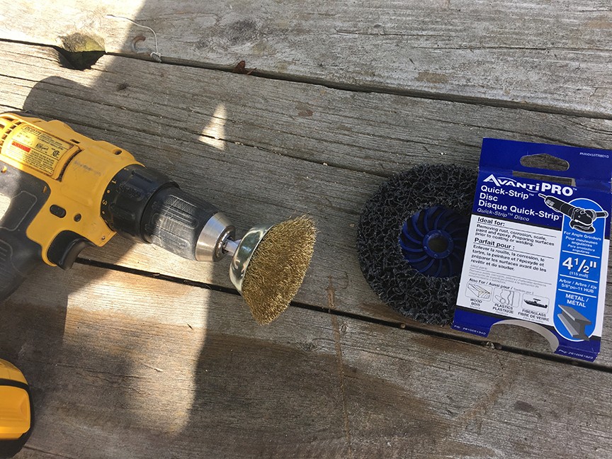

                                Barry, regarding cleaning brick I wanted to share this. I too was looking for a way to get dirt, loose mortar, etc. from the brick surface. Attached is a photo. For what it's worth..... I first tried the wire brush which I chucked up in a drill. Drill doesn't provide enough speed to make this brass brush effectively do its cleaning thing. I didn't feel this worked that great (the reason in a drill, it noted on item no more than 4500 RPMs) Then tried the other item in the photo. This worked great. Screwed this on to the angle grinder threaded mandrel (11,000 RPMs). It wears down with use. needed one for each (in) side of the dome. $7.99 at ACE Hardware, if you have ACE where you are. I'm sure other brands of this type of item would work. There's some items similar at Amazon. This particular brand item was $14 at Amazon which seemed expensive compared to with what I paid at ACE. Hope that helps........ I also sprayed a solution of 50/50 water and vinegar and let sit for 5 minutes. I don't really think that helped.
                                Good luck, Barry
