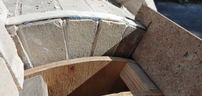

That's one of the reasons I flared the opening of my chimney throat, to increase the initial opening size help coax a more laminar flow of exhaust gas up the throat and into the chimney flue.
The underside of my square throat is flared out for a larger opening, it's roughly 10" square, of 100 sq inches.
The actual dimensions of the throat at the top (square sides, without the flare) is about 8" square, or 64 sq inches.
My chimney pipe is an 8" ID round, or about 50 sq inches.
That stepped approach from larger to smaller (100>64>50) seems to work well on my oven.
I do get a bit of smoke coming out of the front arch when initially starting my fires on the landing floor, right under the throat and just inches from the front arch. Once the fire is burning, most everything goes up the chimney. My chimney is a 4' tall length of double-walled pipe. Once the fire is burning well and I move it back on to the dome floor, I get zero smoke out of the front.

Right - so the beautiful sculpting you did on the throat brick actually widened the throat in the vent to make a smoother transition of smoke TO the chimney.
Makes sense.

My question lies in the potential loss of vent length if I flare it ... the angle of the flare from 22" at the door to 25" at the mouth will have to be compensated for in the heat break cuts at the mouth of the dome.
As such - this slight angle has the potential to pull the length of the vent in more than a non-flared opening.
in fact - it makes the lip-design you shared harder to do.
in my head it suggest the 1/2 brick cuts around the throat will be cut again to 2.5" at the dome opening arch and about 2" at the vent opening arch ...
The 2.5" cut at the mouth of the dome would be made smaller again by the need to flare at the sides - compromising the lip. no?

Question for you.. what did you use to cut your CalSi board with? Maybe you mentioned it and I missed it? (You supplied great pics in post #44.. and mentioned cutting the board but didn't see what you used..?)

As for your question: I cut the Cal-Si board with a simple jigsaw! Went through it like butter!
But BE SURE TO WEAR A MASK (not that we need such encouragement these days) ... it has some nasty stuff in it and you don't want to break this as it produces particles in the cut!
