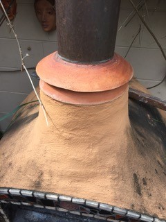

                        Click image for larger version  Name:	IMG_1499.jpeg Views:	0 Size:	23.7 KB ID:	438356 I think your plan is sound except for the use of the high temp silicone in that position. It will not stand up to any direct flame impingement so if it’s at the top of your flue gallery I’d expect it to fail. I use it higher up and it works ok, although last year my wife killed it when she fired the oven and allowed flame to go up the flue. My oven has been working well for over 10 years. Not to difficult to redo in my case, but yours will be covered presumably and difficult to get at. I should think the mortar holding the bricks in position should be sufficient.

                          david s thank you so much for such a quick and informative reply! I had read your issue warned to others about the folly of the flame up the flue and I suppose, yes, placing it as a base for the plate does put it in that peril of exposure to flame if they ever got up that high.
                          A brick and mortar sandwich seems to be the call.
                          Thanks again!
