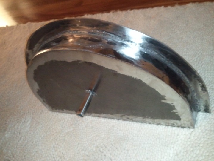

              Your picture is about exactly how I built my door.
              Welding stainless is tricky. Do you have experience?
              Also, personally I found it easier to use blanket inside the cavity than using board. You can stuff it pretty full of the blanket, and you don't have to trim bits off the edges of the board which makes nasty dust.

                #232
                Re: K79 Oven Build
                [ATTACH]35617[/ATTACH]
                I have a welder / sheet metal guy that is right down the street from my office. That is pretty much what I want to do. The only difference is I was going to put some steel on the back side to. Why did you leave the board exposed on the back side of the door?
                Link to my oven build on YouTube:
                http://www.youtube.com/watch?v=Ujb7lqVcSzQ

                  #233
                  Re: K79 Oven Build
                  ooh ooh me! I think I know!
                  I think he is trying to ensure that the heat is not transmitted directly from the front surface to the back surface of the door, which would happen much more if the front and rear metal surfaces were connected.
                  How did I do?

                    Re: K79 Oven Build
                    I'ld say you're right, but I would think you would want to keep that cal sil board as far away from anything your going to eat as possible.
                    That cal sil board is very expensive. I have 3 or 4 pieces that I could fit together to fill my door so leaving the back open kind of isn't an option. Unless I used some kind of mesch to hold it in???

                      #235
                      Re: K79 Oven Build
                      I wonder if you could spray the CalSil Board with High Temperature paint? I was considering doing that while my build was in progress in order to protect the board against moisture - but it did occur to me it might help stop dust flying around as well.
                      You would only use the door once the temperature of the oven had stabilized - not while you had a full burn going. So the highest temperature the door would see would be seven or eight hundred degrees (F) I would think? And most of the time it would experience much lower temperatures.
                      http://www.fornobravo.com/forum/8/32...a-19283-2.html
                        • 5264
                        #236
                        Re: K79 Oven Build
                        BW/K79,
                        I guess I am not seeing what you guys are seeing, DJ fully enclosed his door with a SS/CS band and back plate and welded everything closed after stuffing with CF insulation.

                            #238
                            Re: K79 Oven Build
                            It's steel on all sides. The silver you see is just the result of grinding off my ugly welds
                            You're lucky to have a metal worker friend. But Stainless also costs about 5x as much for the metal
