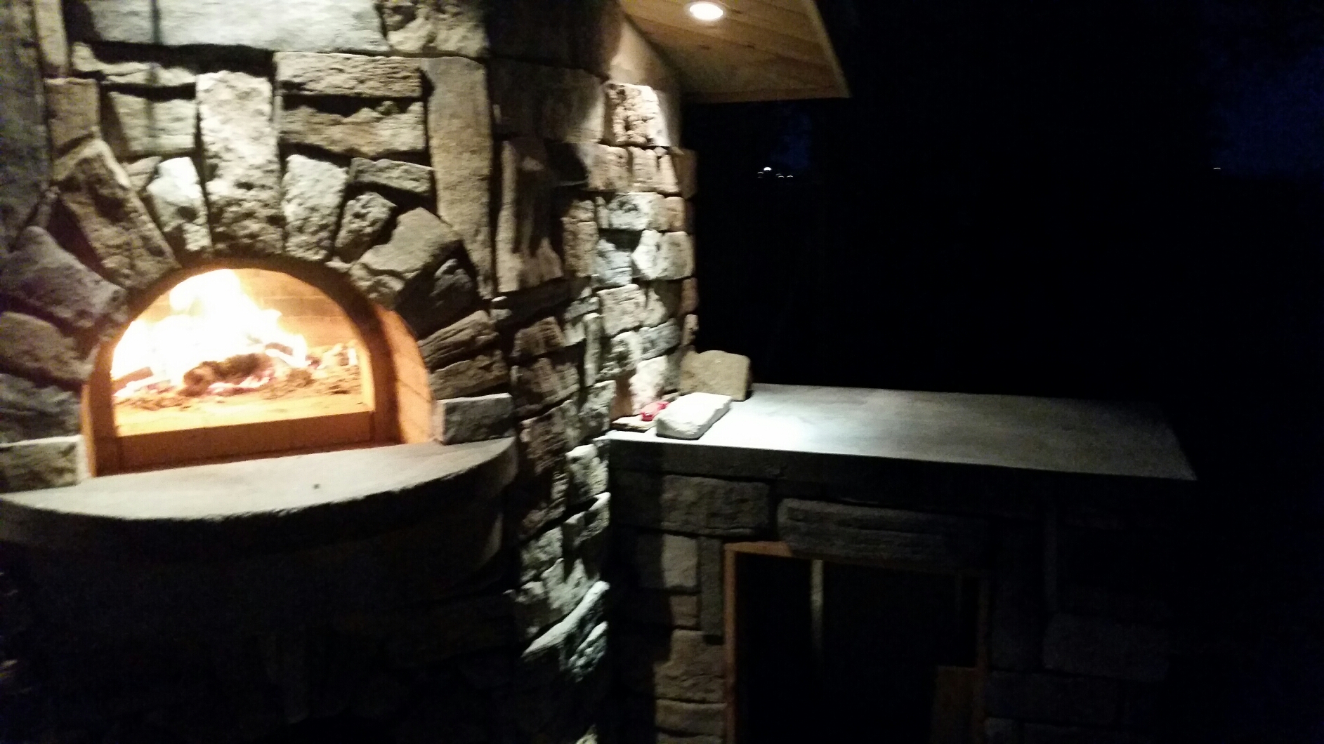

              Well I am almost done with the oven. I have my lighting in and have had my first pizza party. Everything is going well. I hope to have the stone work done soon. We will see if this goes through. I will try to post more later.

                I have been progressing with my build. I have slowed a little bit now that every thing is,at,least use able. I am all done with my deader young and grove soffit. I am trying to,decide if I should just put a clear sealer on it to try to keep the natural color or if it will still fade and in that case maby I should stain it a color close to the natural deader color. Any suggestions? I also have finished my lighting. I don't remember if I said what I was going to do so,sorry if I am repeating myself. For the lighting I took some 3" can lights and took them apart, and then mixed the with some landscape flood lights. Both lights used MR16 lamps. So all I had to do was swap the lamp holders as the lamps clamped to the trim ring of the can light trim. They are all 20 watt lamps and I am ver happy with the light output. It is plenty bright to see what you are doing but not obnoxious, and gives a nice bit of drama to the stone.
                As for the over performance I brought the oven up to temp on Saturday and I am not sure just how hot it got as my Ir gun only goes,to 1022 F and it read hi. So I let it fall down a little bit and then it was easy to hold the dome temp,at around 850 on the dome and 650-675 on the floor. I was not timing the cooking but I would say that it was very close to the 2 min standard. The whole dome cleared and was,at the high temp.for 8 hours or so. With no door at all I was at 375 F 18 hours later and 40 hours after the fire went out with no door it was still 170 degrees. So,I am very happy with that. I can only imagine what it will be like with a door.

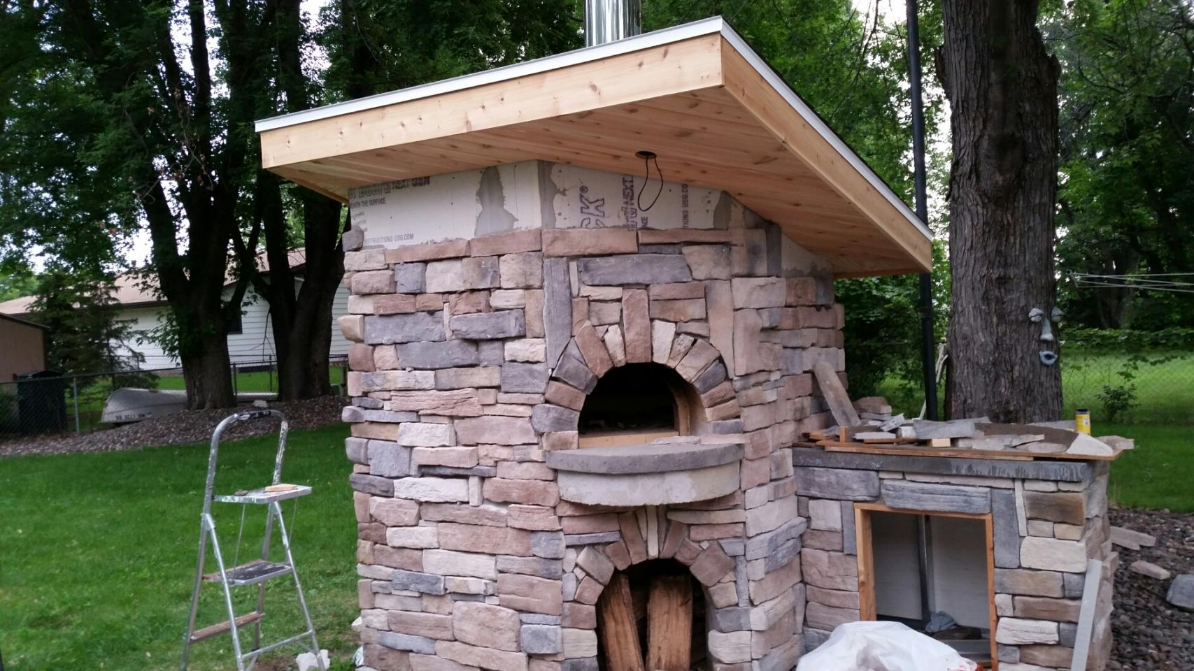

                  It has been almost a month now since I last posted. I have finally finished my stone work on the enclosure. It wound up being almost as much work if not more than building the dome. I am very happy with how it turned out. So now I just need to grout it witch that looks like it will be a job in and of itself. But it feels very good to have that done and I am at least one step closer to being done.
                  I have also finally decided on how I am going to do my vent floor. I after much thought and discussionwith other fourm members am going with fire bricks not stainless steel. For my heat break I am leaving a 3/8" gap witch will be stuffed with ceramic rope and the top will be left to fill with ash. I also am leaving a pice of cardboard as a expansion joint on the sides. I think I am going to stager the joints as nothing else has joints that line up with anything else.
                  I also have pretty much finished grinding and polishing my concrete counters. I was afraid that the one I pored in place would be the hard one to grind and the cast would be easier, but I was wrong. I started with a diamond cup wheel to take off the rough edges then I ordered some polishing pads off Amazon for my RO sander. They worked great and I have pretty much finished up to 800 grit witch is where I am going to stop. It gives it a nice honed finish with just a little shine. But the pice I cast for the oven lip did not turn out as well. Through sand and portland kinda wore away between the aggregate. I think I am just going to leave it though with the rough surface. Things won't be as likely to slide off that way. Or maybe I am getting lazy. But now I need to seal them after one more round with the 800 grit.
                  So now all I have left to do is grout the stone seal the ceader and stone and counter tops, make a door for the prep station and make a door for the oven.
                  I have used the oven a few times now and made 24 pizzas so far. It has performed as expected or better. I can't thank you all enough for the help you have given me. I know it would not have turned out as well with out everyone here. So thanks again.

                            Well I finally got around to starting the grouting of my stone veneer. It went better than I thought it might. I spent an hour or so and got half of the biggest side done. So I think about 4 or 5 more nights like last night and I will be done. I am planning to get it done by the time the snow flies.
                            I am now up to 36 pizza out of the oven. It still amazes me how it can cook so fast and still not burn.
                            Randy

                              Awesome! Looks great! Love the asymmetry of the roof, how you rotated it to be square to the side of the oven. Good job with the stone as well! We all understand how much work you put into it. It's not a weekend DIY project. Very impressive. Enjoy your oven!
