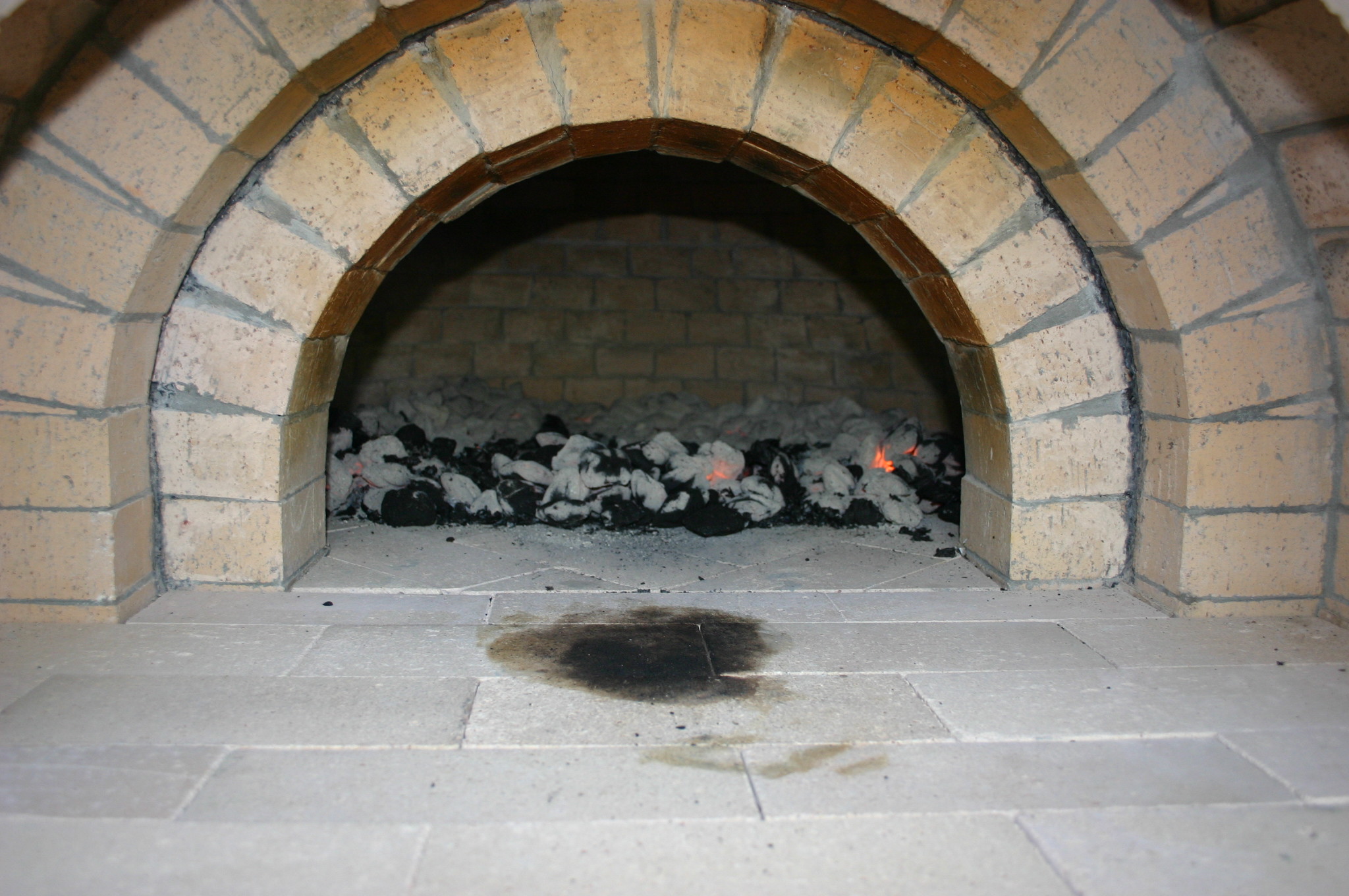

                        Re: Randy's dreams do come true oven build
                        For the first drying fires, charcoal briquettes or lump (lump burns hotter) is a little more forgiving. They can be started in a chimney and then placed around on the oven floor. No charcoal starter fluid, though . Paper only .
