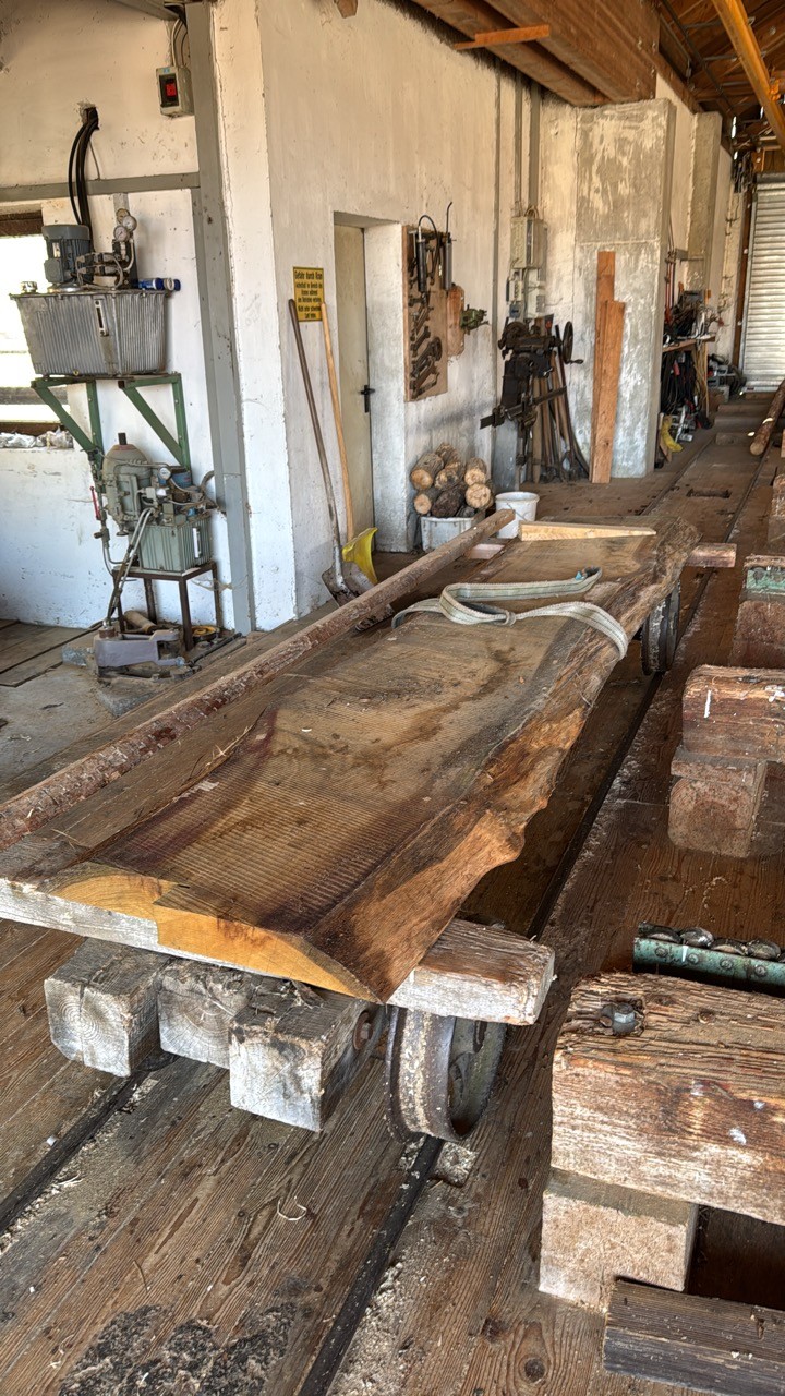

    Oak Table
    I picked up a nice slab of oak about 6 weeks ago. 3300 x 800 x 85mm after I finished cleaning it up. It’s still not fully dry, as it was sliced in end of 2023. So I‘m letting it be for a couple more years before finishing it off with a router sled to flatten it perfectly.
    I was on the lookout for some rough cut dry oak, and a few weeks ago found some that was cut 13 years ago. I took it to my local sawmill where I was able to use the machines to cut it down to size, and build it into a nice solid oak stand. I did that this week, and got it home yesterday. Looks really nice on the terrace next to the pizza oven.

    It‘s heavy, so I know no one will ever be able to walk off with it . Sits 12 people easily. I have 2 x 3300 x 400 x 50mm slabs of oak I also machined down this week. Now to work on building some legs that will match the table.
    So we‘re in for some 22C days this week, perfect weather to work on finishing the final layers of render on the dome.

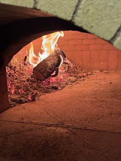

    This is an amazing working (and serving) space! As much an art exhibition as a working WFO Thank you for documenting and sharing this remarkable build with us!
    Thank you. It’s been a joy to build. Challenging at times, but well worth it and I would highly recommend it for anyone who has a passion for pizza. At this point its come down to finishing the details, and I’m looking forward to our first summer being able to use it and enjoy it with our family and friends.
    There were parts of this Neapolitan oven build that I had to really research and consider. David was especially helpful and his generosity in sharing his knowledge and experience was a great support. I wanted to document and share my build process in the hope others might find it helpful.
    I’m grateful that Forno Bravo have been so generous in sharing the plans and this forum as such a great support resource. The oven has far exceeded any expectations I had. I just finished my first 20kg of flour, and as much as I have learned, there is so much more ahead.

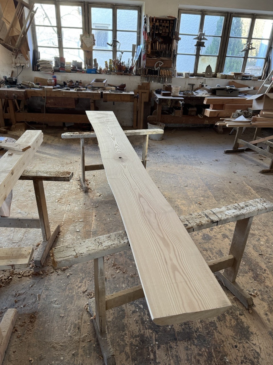

  • daidensacha
    replied
    Oak slab for table top
    I picked up a nice slab of an old oak tree. 750-800mm wide, 100mm thick, 3500mm long. Got a little bit of work to tidy it up, and a base to build, but it’s a beautiful piece of wood. As a table in the terrace to eat pizza on, it will be amazing. I’ll hit it with a plainer and sander in the next days.

    Ash bar has been put through the plainer at the local mill. I removed the bark and cleaned up the sides. Next step is to cut it to fit on the wall behind my food prep bench. It’s a lot lighter than oak, but the nice dark brown heartwood is a feature.
